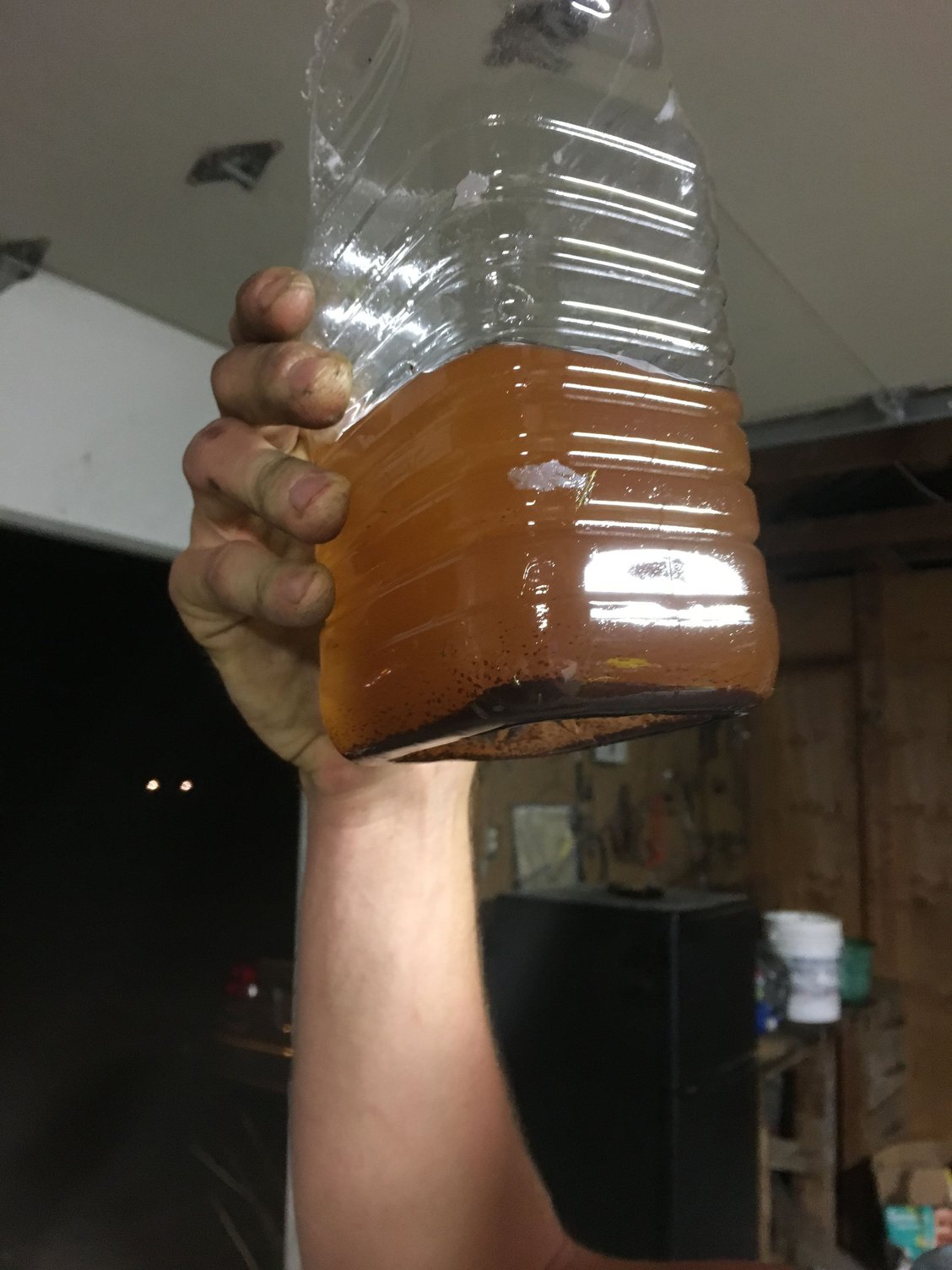

I ended up tearing into the bike tonight. Got the tank off and took the pump out. Tank is full of what seems like rust. Sloshed some fuel around in the tank and poured it into a clear container, there is a lot of garbage in there. Took the outer “fuel filter” off the pump and cleaned it out. I’d rather fix this tank than buy a new one, will probably try vinegar to dissolve the rust.
Would make sense that this is the problem, it ran good while the filter was filling up with garbage, and then off and on since then when sufficient fuel couldn’t be delivered.

That could be your problem, I know in the US there are a lot of Preparatory Fuel tank Fluids but just look at You Tube and decide the best for you, You might even just get away with a good flush now you have cleaned the tank out
