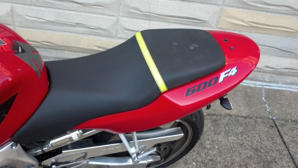

Made some more progress today. Got the DOT turn signals and front amber reflectors mounted. I still need to wire up the signals. I also bled the brakes and made my passenger hand hold. The old brake fluid had a slight brown tint to it. I'd say you could compare it to the color of budweiser when it should be closer to bud light. Tomorrow or Sunday, I will connect up the signals and test them out, remove the wind screen, and secure the wiring up under the headlight(they actually faulted me for hanging wires). Pics below.

Good job on the strap.
