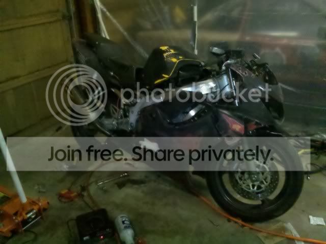

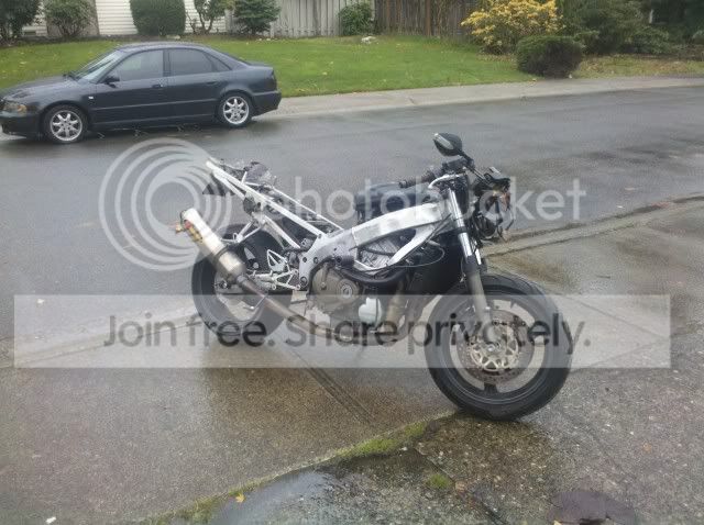

I sprayed the bike in a semi gloss black, with gold accents. The bar ends, levers, windscreen bolts and some other pieces got painted gold.
Also painted the wheels gold, but i might go back to black. Maybe black with a gold stripe.
