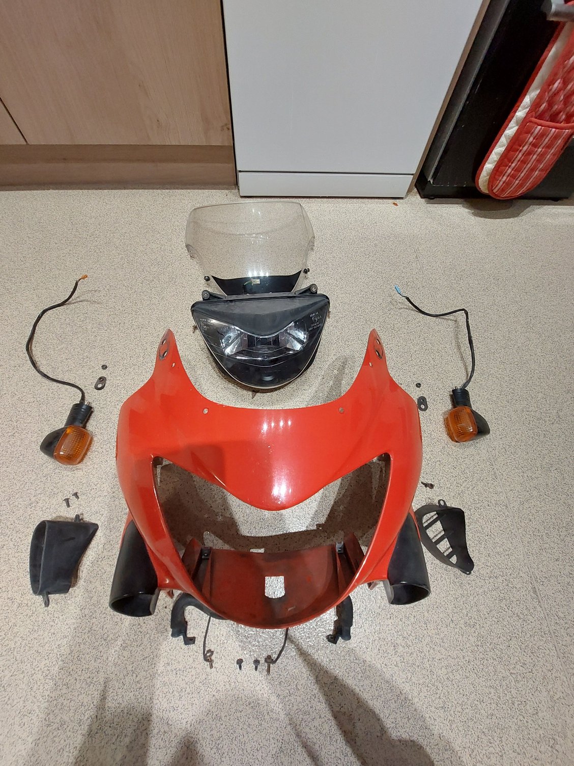

Hi Im wondering if anyone has a picture of their front stay cowel? Im trying to figure out if the headlight on the 2000 f4’s mount into the plastic or a separate bracket

I don't have a photo of it exactly but the headlight mounts into 4 metal clips directly on the plastic cowling. There is no additional bracket. You can unplug the headlight cables and remove the front faring with the headlight still attached inside it.
