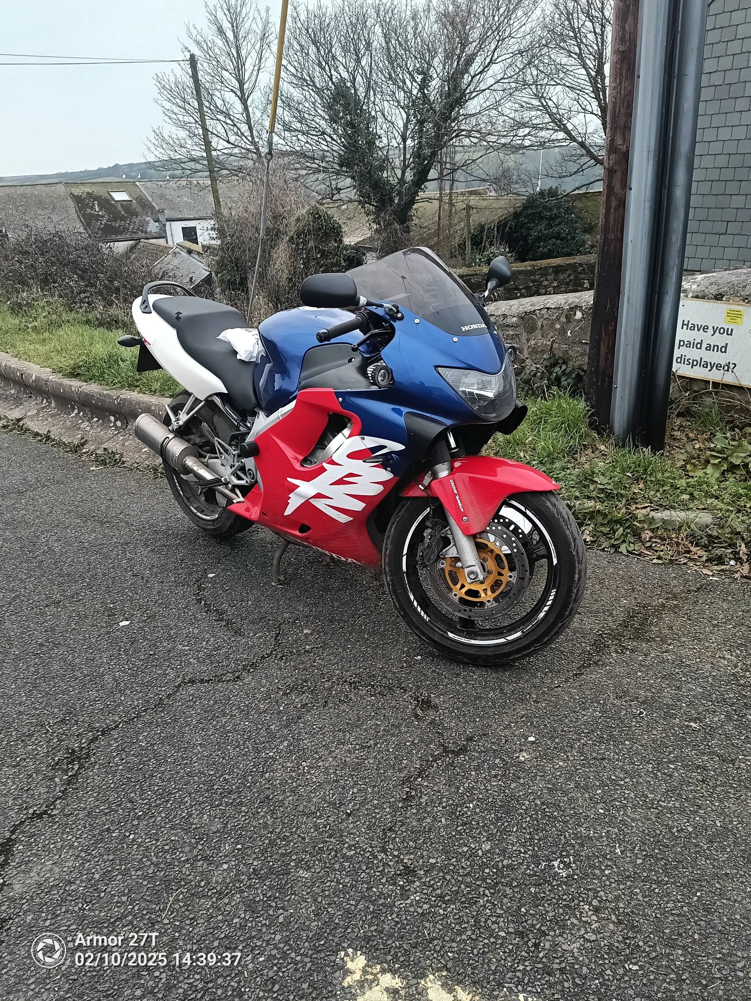

Hello all. New to forums in general so sorry if I'm supposed to introduce myself... I have a 2000 cbr600 f4 fy carb runs well it has a stainless 4 2 1 manifold unknown brand stock one rotted at collector a leovince shortened titanium slip on air filter is a high flow brand is that performance over stock filter? Anyway cleaned carbs properly all airways cleaned ect all stock fueling. Fuel pump started playing up so installed electronic pointless system onto stock pump worked flawlessly
​​​​​​ Now the problem if it is one. As the temperature dropped the bike seems less keen particularly over that magic 7 8 k rpm which id exspect the bike to perform better when cold denser air so I'm questioning maybe it's lean? Also when cruising light load the engine sputters just like a 2 stroke does under light throttle cruising which may be a carb thing but I'm not so sure she pics up fine although did hesitate in second when I gave it the beans. Anyone had any experience with these bikes add there two pence worth? Need a dynojet which is only available as stage 1 for stock setups on there email on my bike Thanks. I'm newbie to larger bikes loving it previous to this I had a 2 stroke suzuki ts125r
