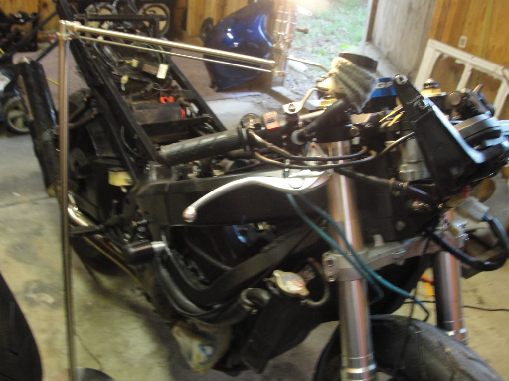

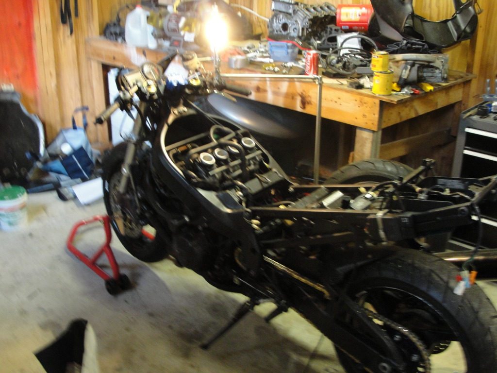

So I walk into the garage and see the poor bike sitting like this

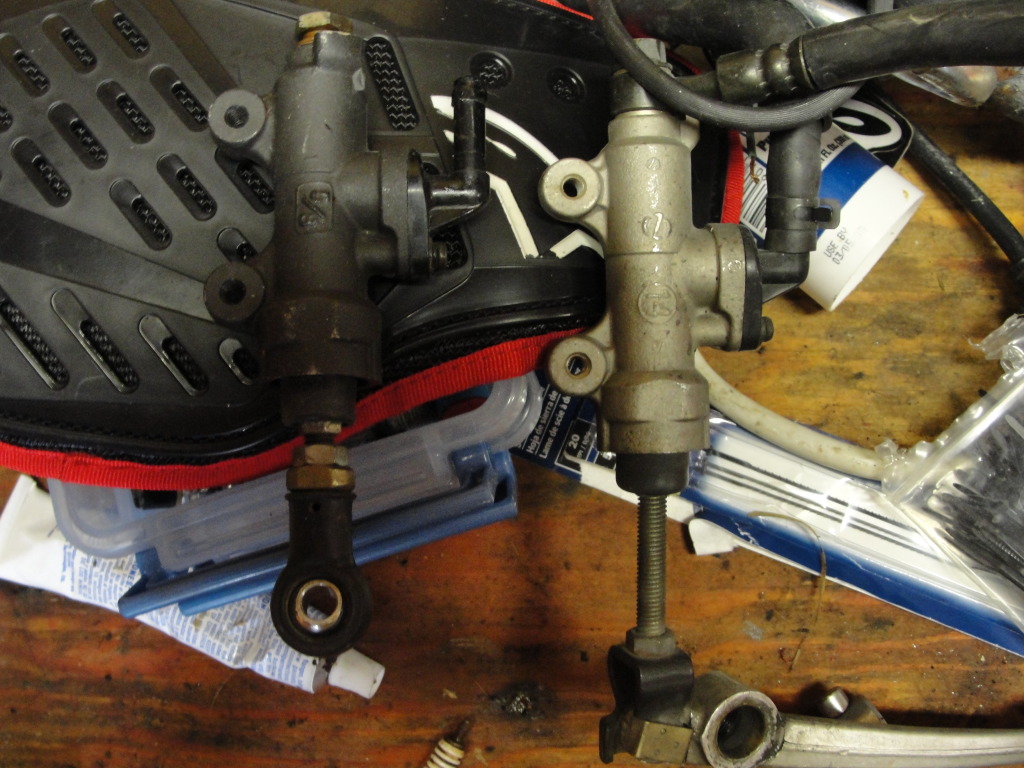

I haven't finished my rear braking system the upgrading....
so my old system original f4.... and my new improvement cbr 1krr
Here is everything appart.

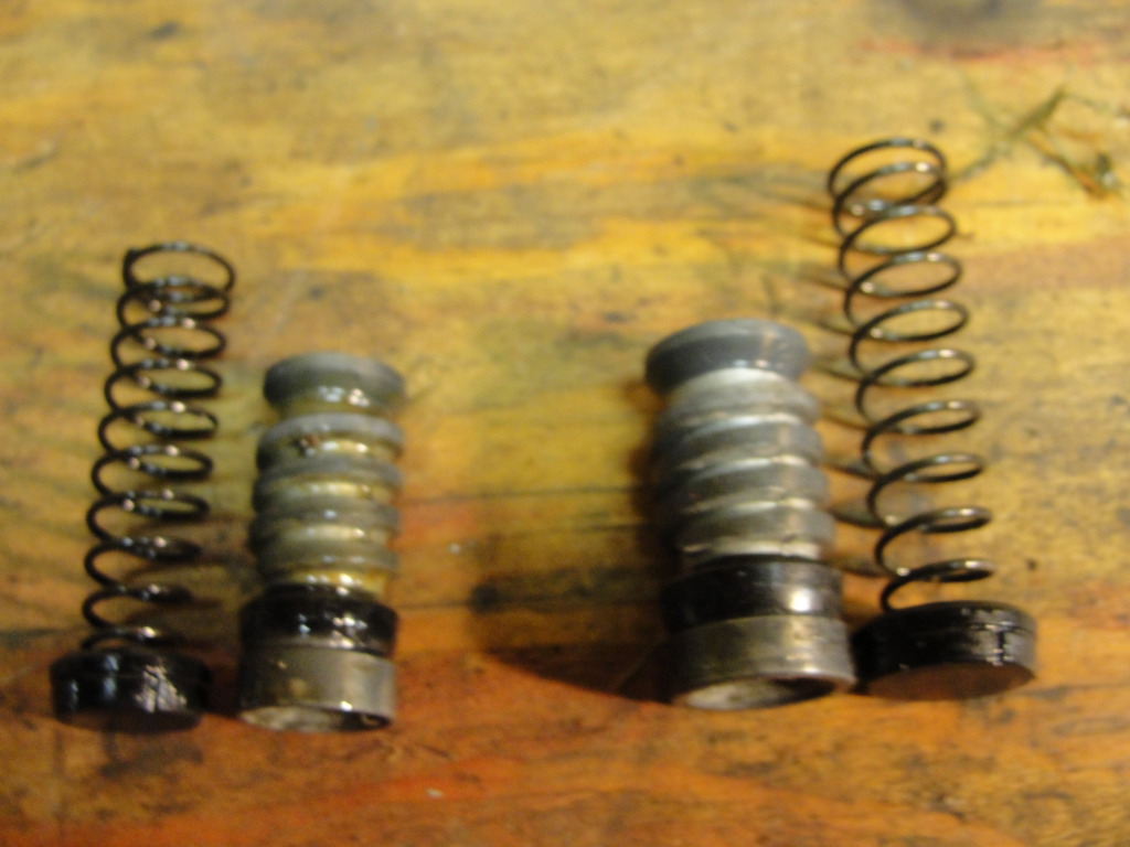

now they look the same but if you check this out here are the springs and pistons

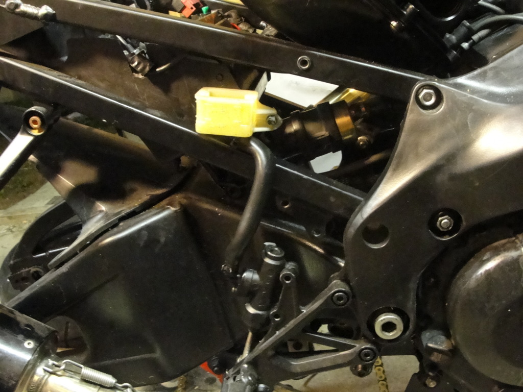

and now everything is all done.
I used the 1krr resi and custom did the line and mounting location.
