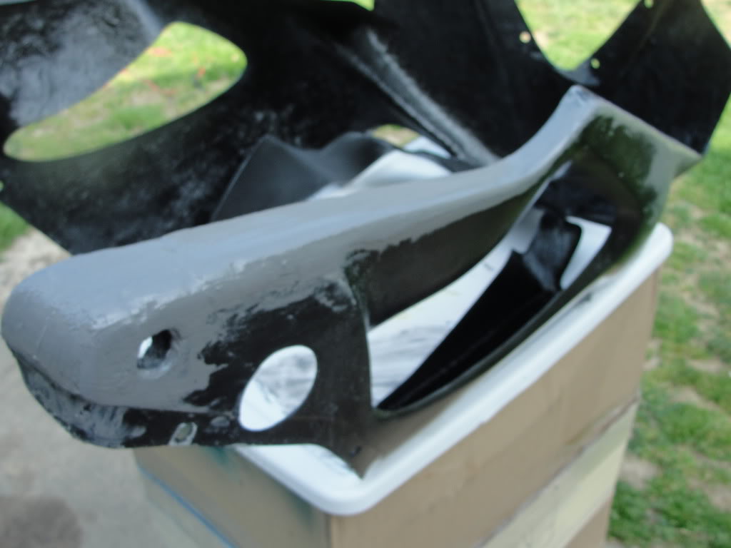

Now while i'm waiting for parts i'm going to start working on my race plastics.. they are pretty beat up.

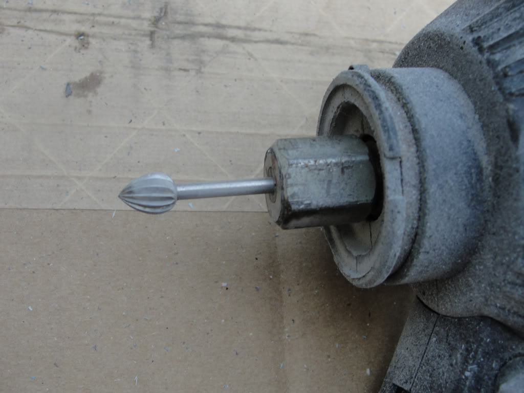

ok first you will need a tip

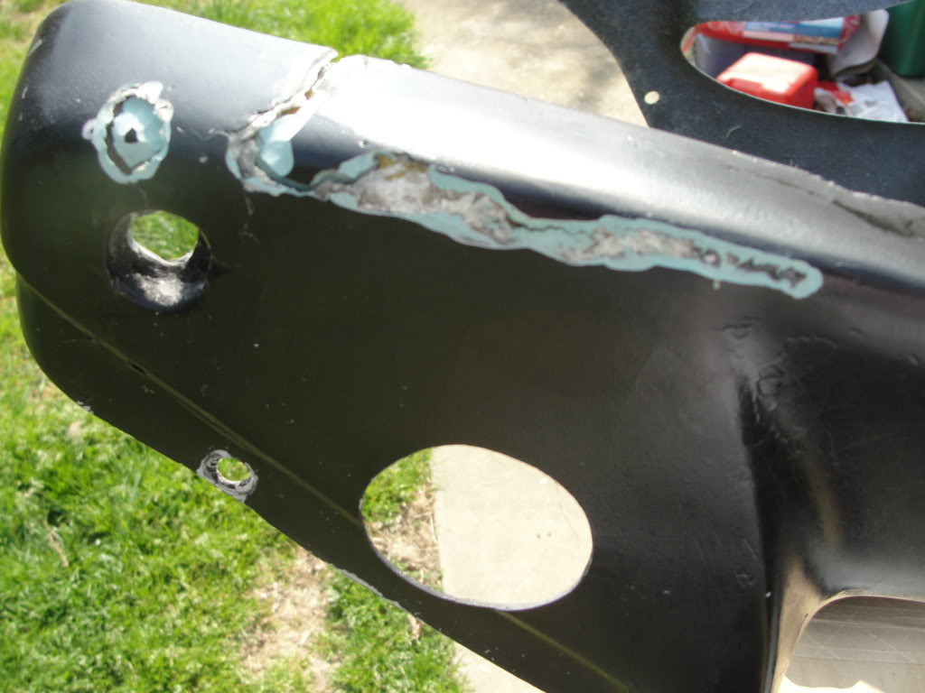

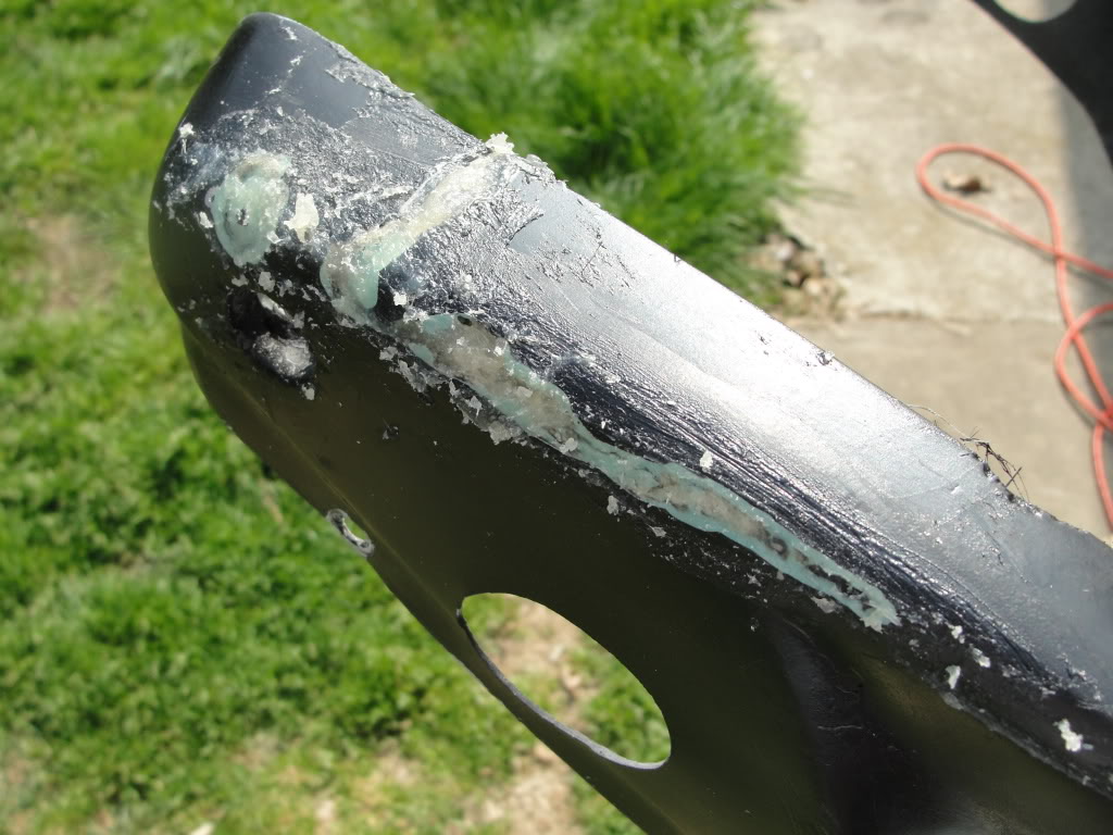

ok so what you want to do is find the cracks and cut into it with the tip.

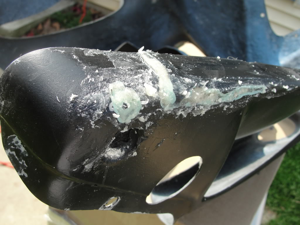

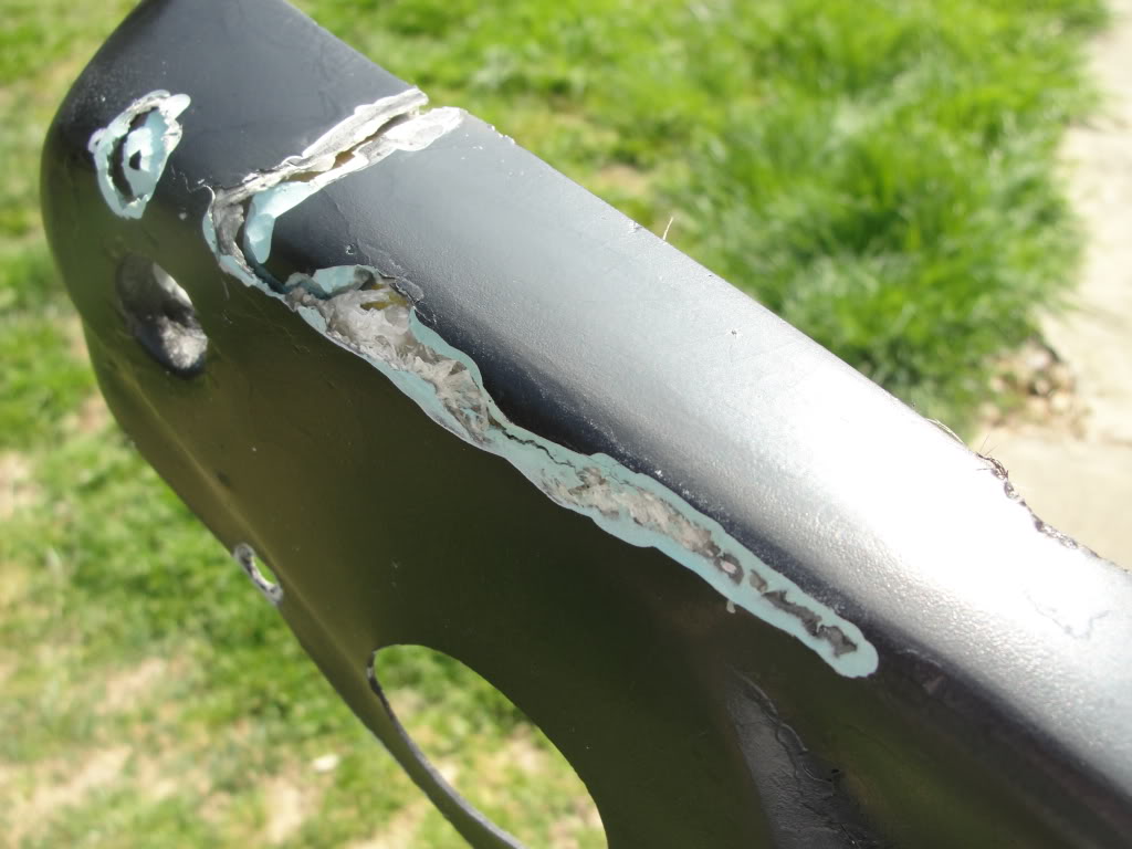

now next you want to use the epoxy

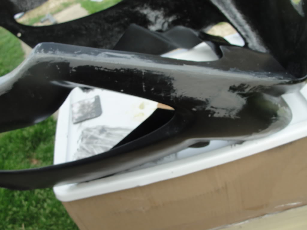

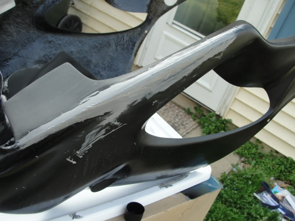

and now use some sand paper about 40- 80 grit and sand down the epoxy once it's dry.
then use JB weld... little tip use bondo applier to limit the ammount of JB weld you have to sand.
