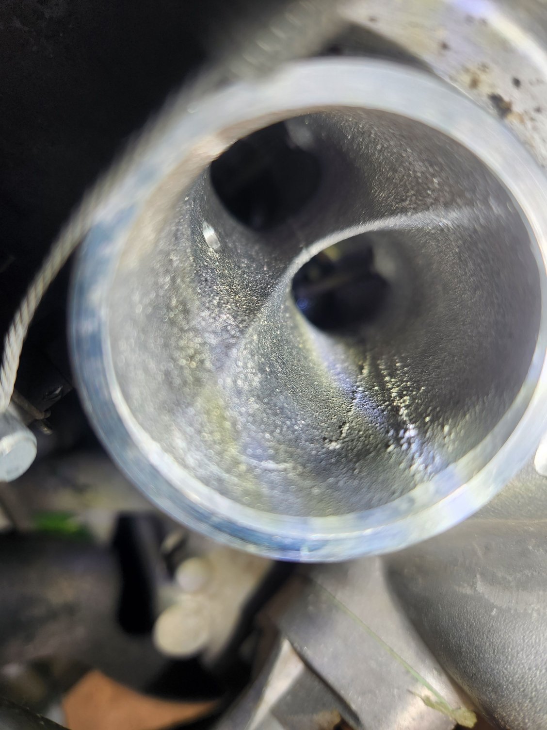

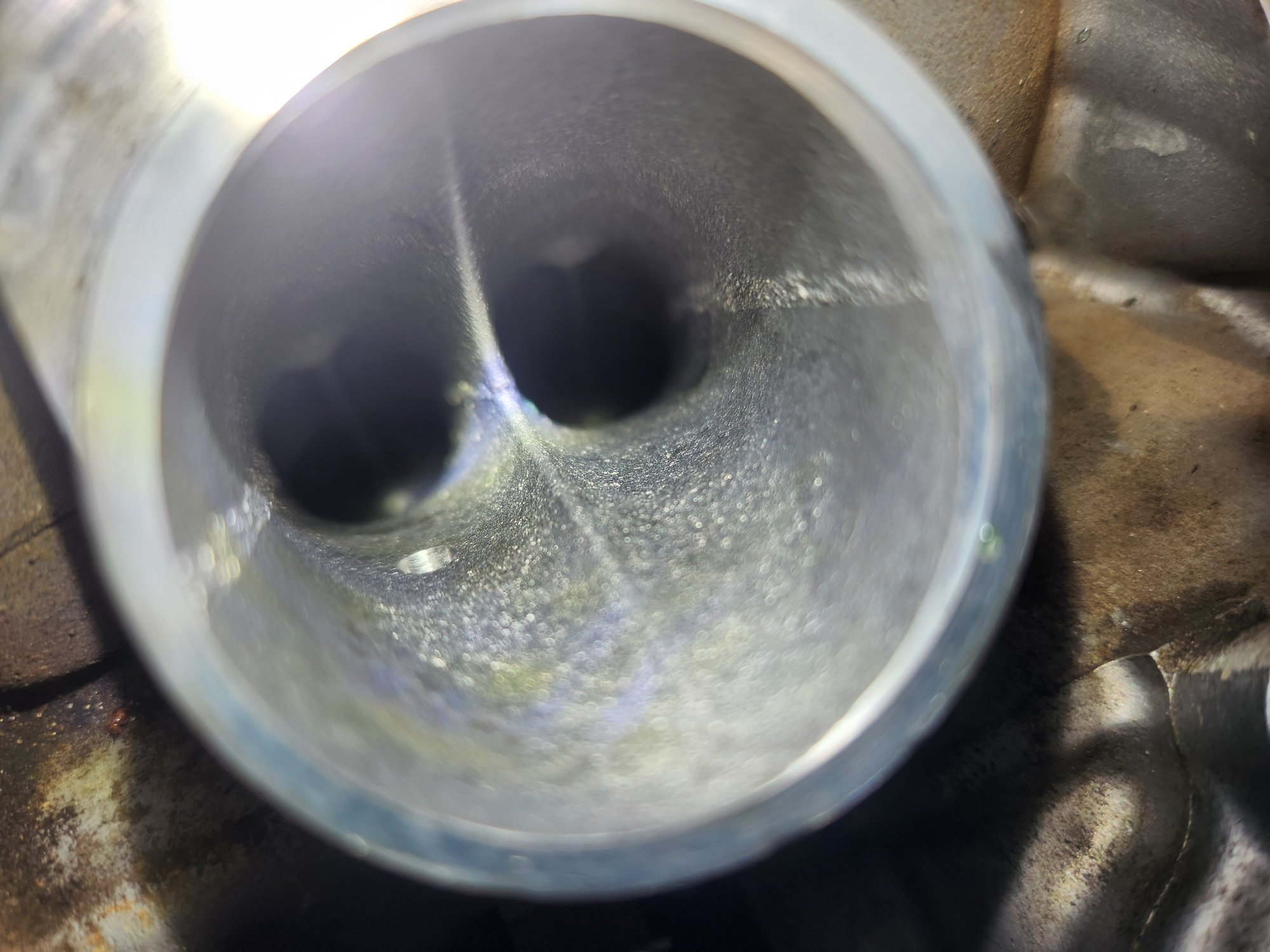

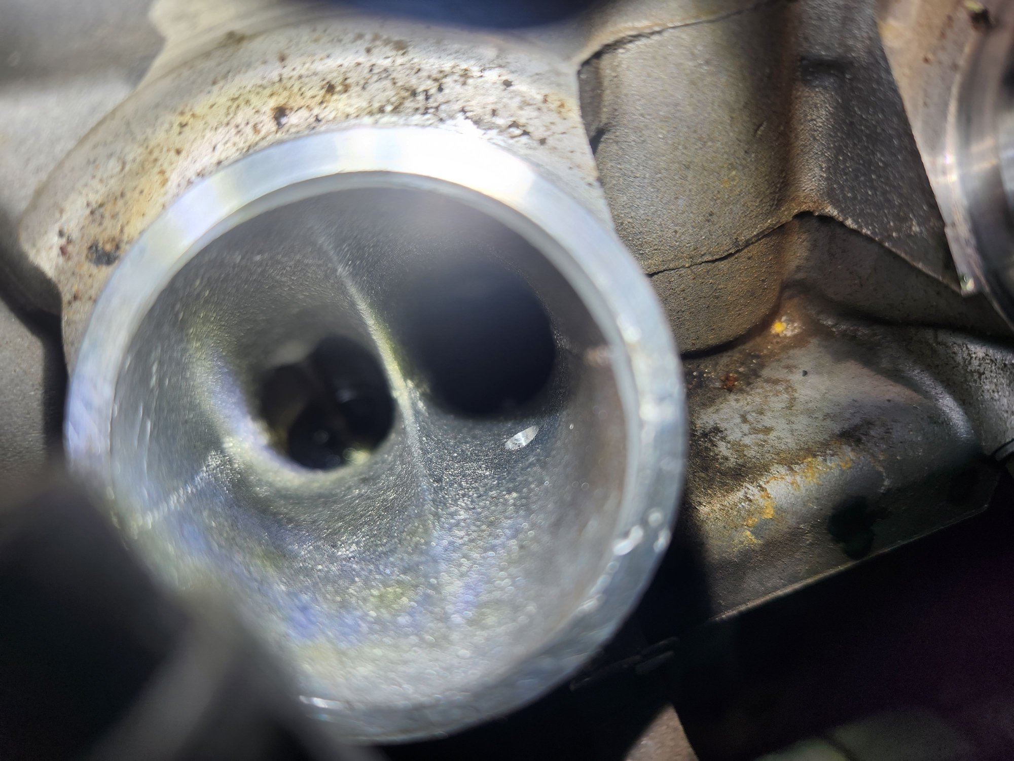

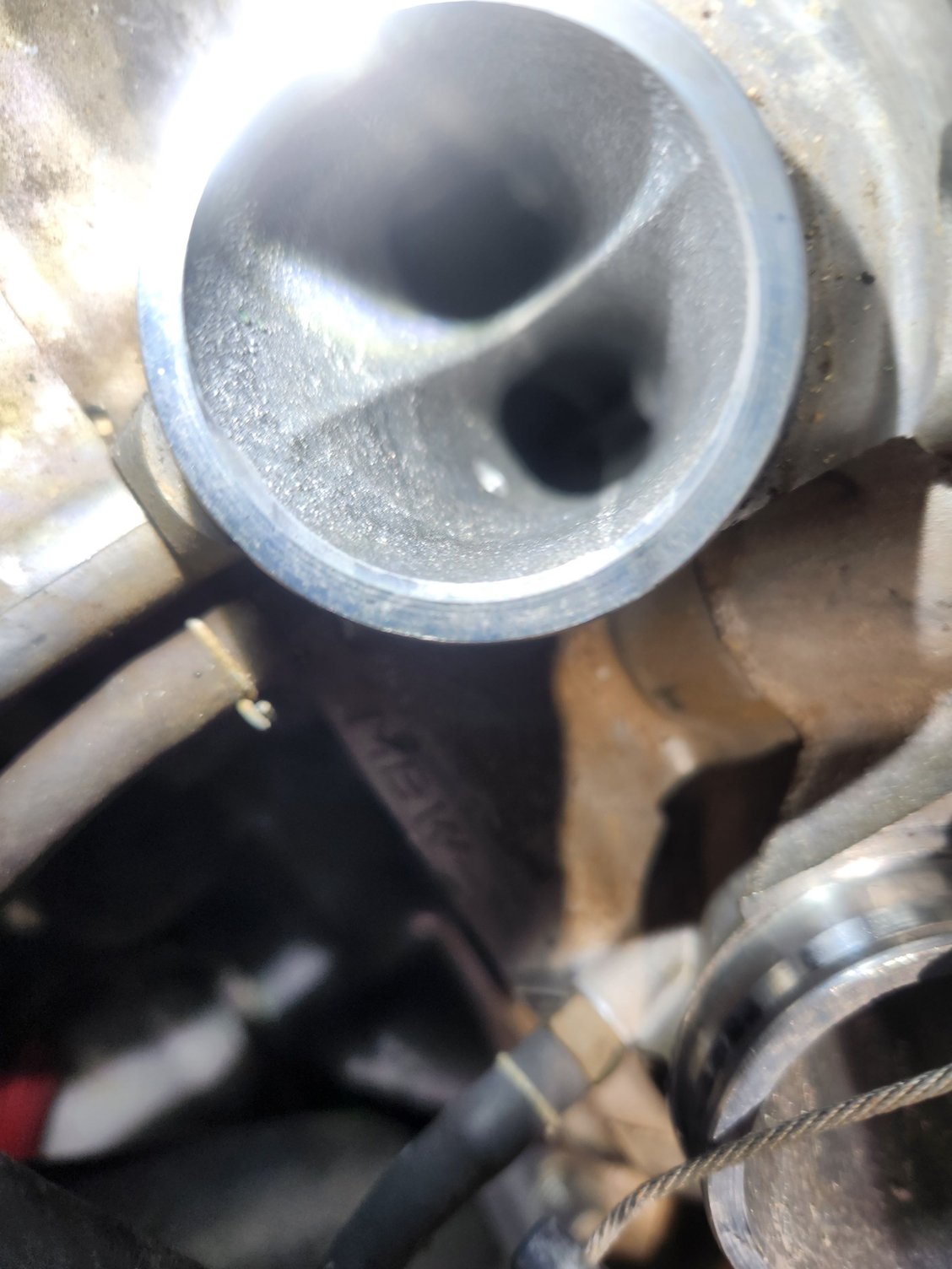

I've finally got the carbs apart. Took a while to get into it bc of the ridiculous weather in Michigan. I was a little worried at first bc the keys and pilots seemed to be clean and didn't find any dirty or gunk until I got into the diaphragms. I do need some advice to. When i took the carbs off I looked down into the motor and I'm guessing those are the valves I see down there. A few of them look like they are covered in black gunk. Should i spray the carb cleaner down there or is there something else I should do other than ripping the whole motor apart? Any help would be appreciated.

Dude, same exact thing was happening to me,,,got my 99 f4. Got a lil excited with the aibox mods & pair mod.... long story short,Did some diggin,,, Honda 599cc is flagship for a reason.... they know what there doin. Under the 15-18 mph the carbs run pilot circuit.....after they run power circuit w pilot circuit CLOSED the two floatbowl vents (INNER& OUTER) is controlled by the what ??? Any body ??? Bueler ??? ☆☆PAIR VALVE☆☆ controls the Diaphram Vents in those cycles... when both are naturally aspirated both cuicuts are open they floods,,, ....the pair solenoid prevents that..... reminded myself to keep it simple stupid......hope that helps
