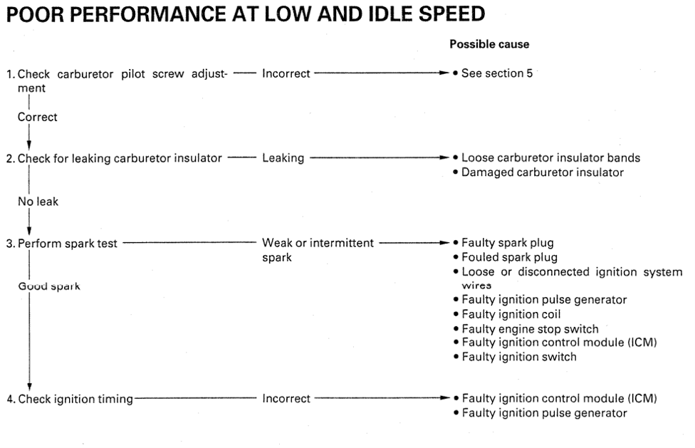

For info Troubleshooting from the manual

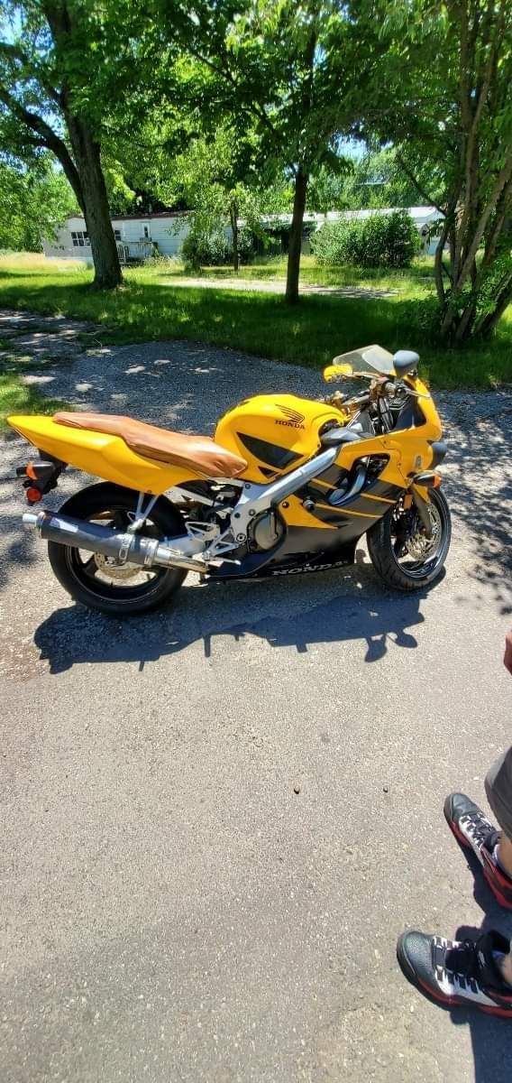

How the bike was when i got it.

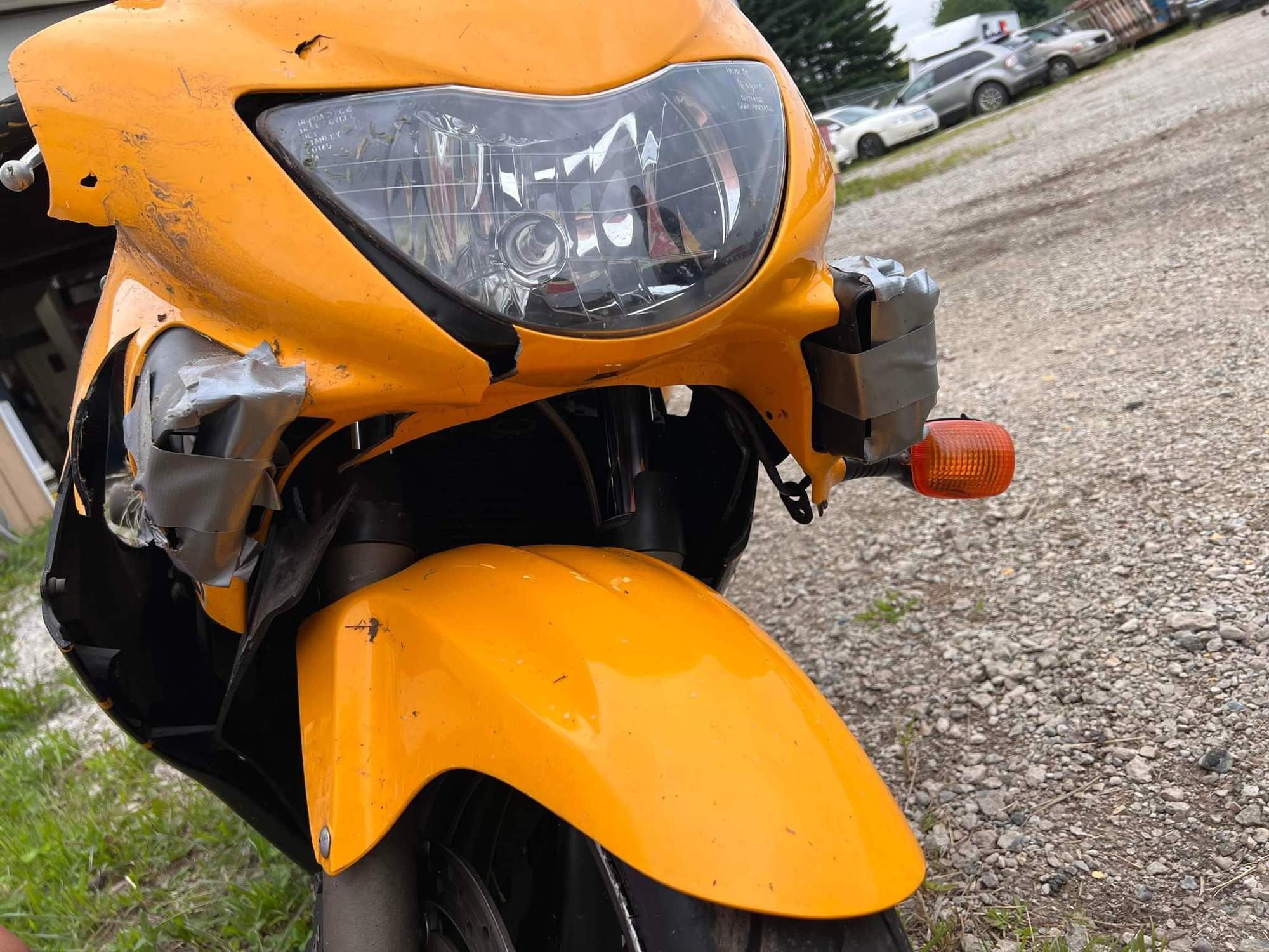

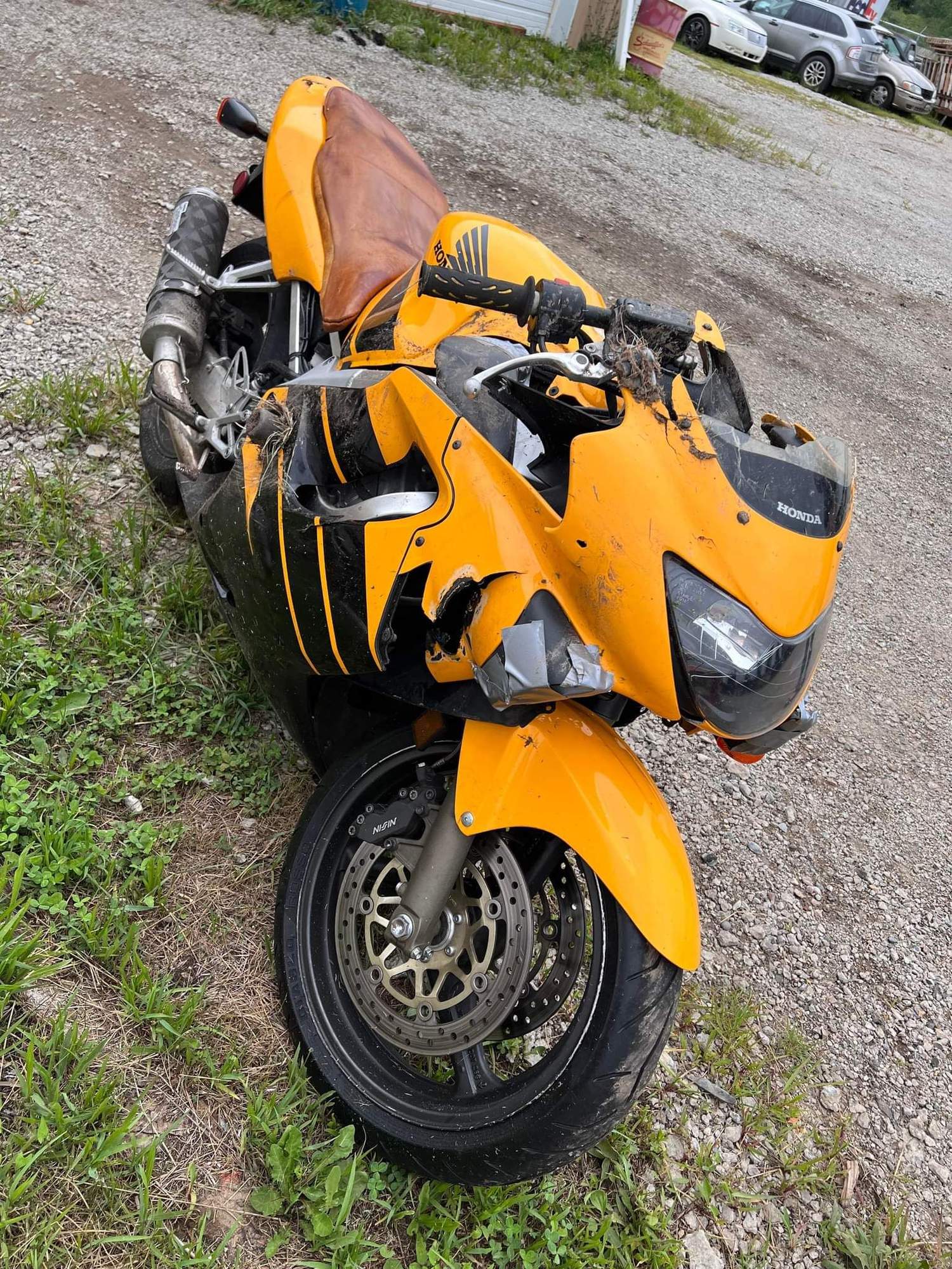

After stolen and wrecked

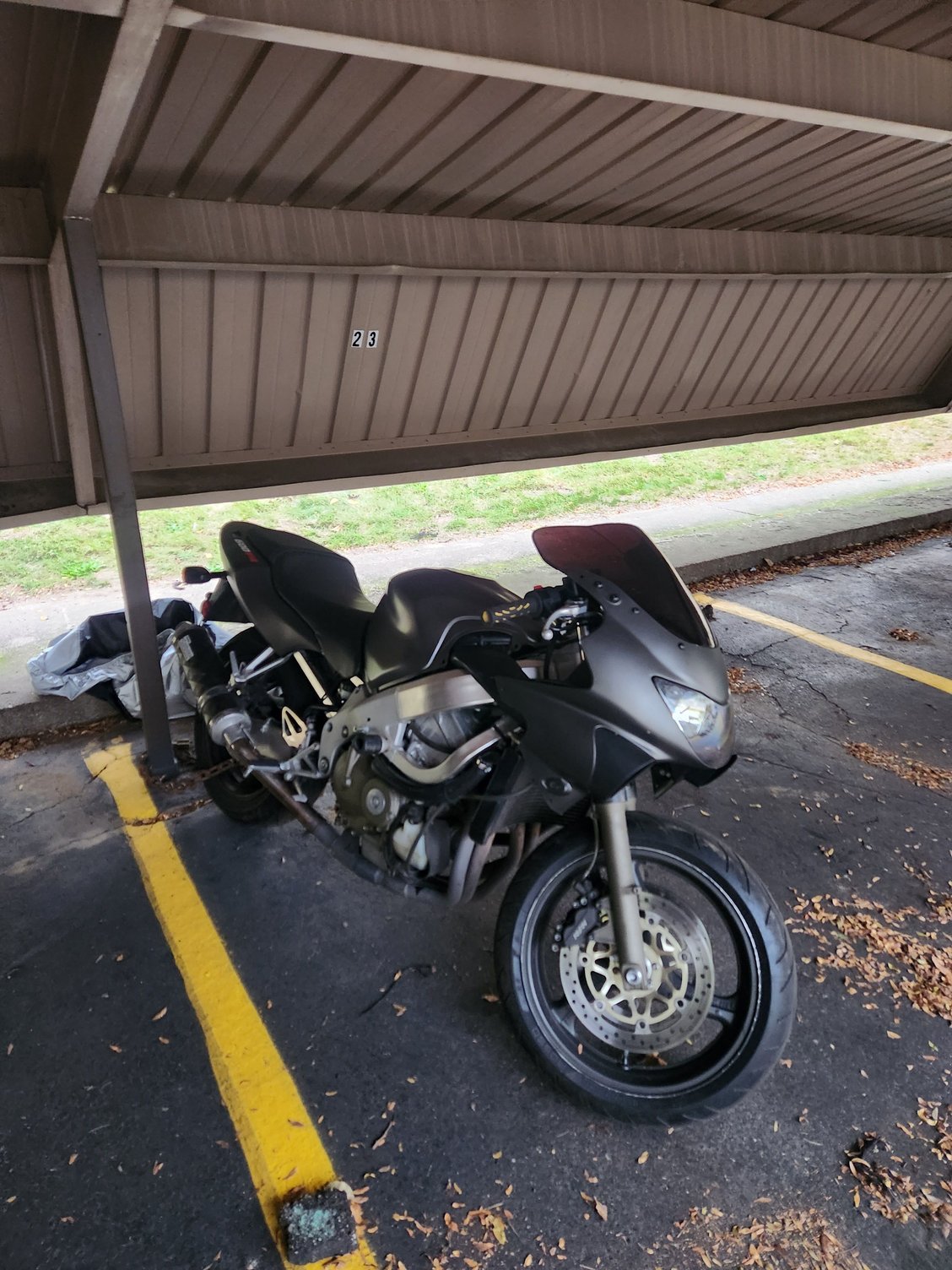

How it currently sits

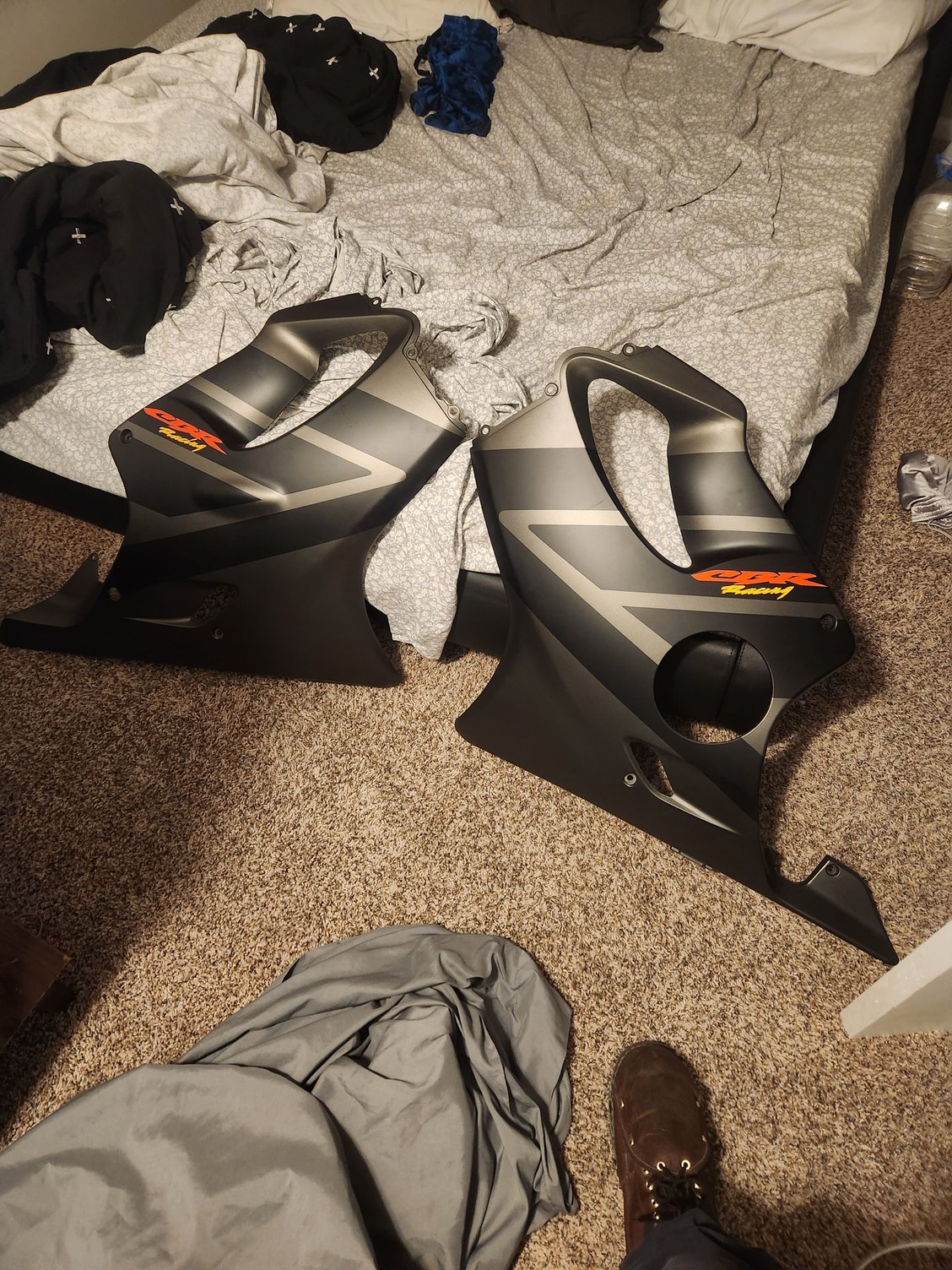

Side fairings i havent put on yet

Here's some pics of the bike. I don't believe it was the kn air filter bc it did it from the start. I'm going to hopefully get the bike taken apart and see if I can find any of the issues you told me about this weekend. I'll give you and update afterwards. I appreciate the help bc I didn't want to just throw parts at it while guessing and really want the bike ready to ride when it warms up. Figure next year I'll be ready to move up to a liter bike if I get this season of riding in

That's such a shame, but you have done a really nice job on the re-build. I really like the colour very stealthy!!
