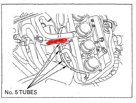

investigated my problem over the weekend and found that i had forgotten to plug in one of the hoses (colored in red in photo). i had also taken that time to make sure my TPS was adjusted correctly. Idle should measure between 490-510 ohms and it was measuring a little above 600. so i plugged in the hose and adjusted the TPS and now it seems to run fine.
