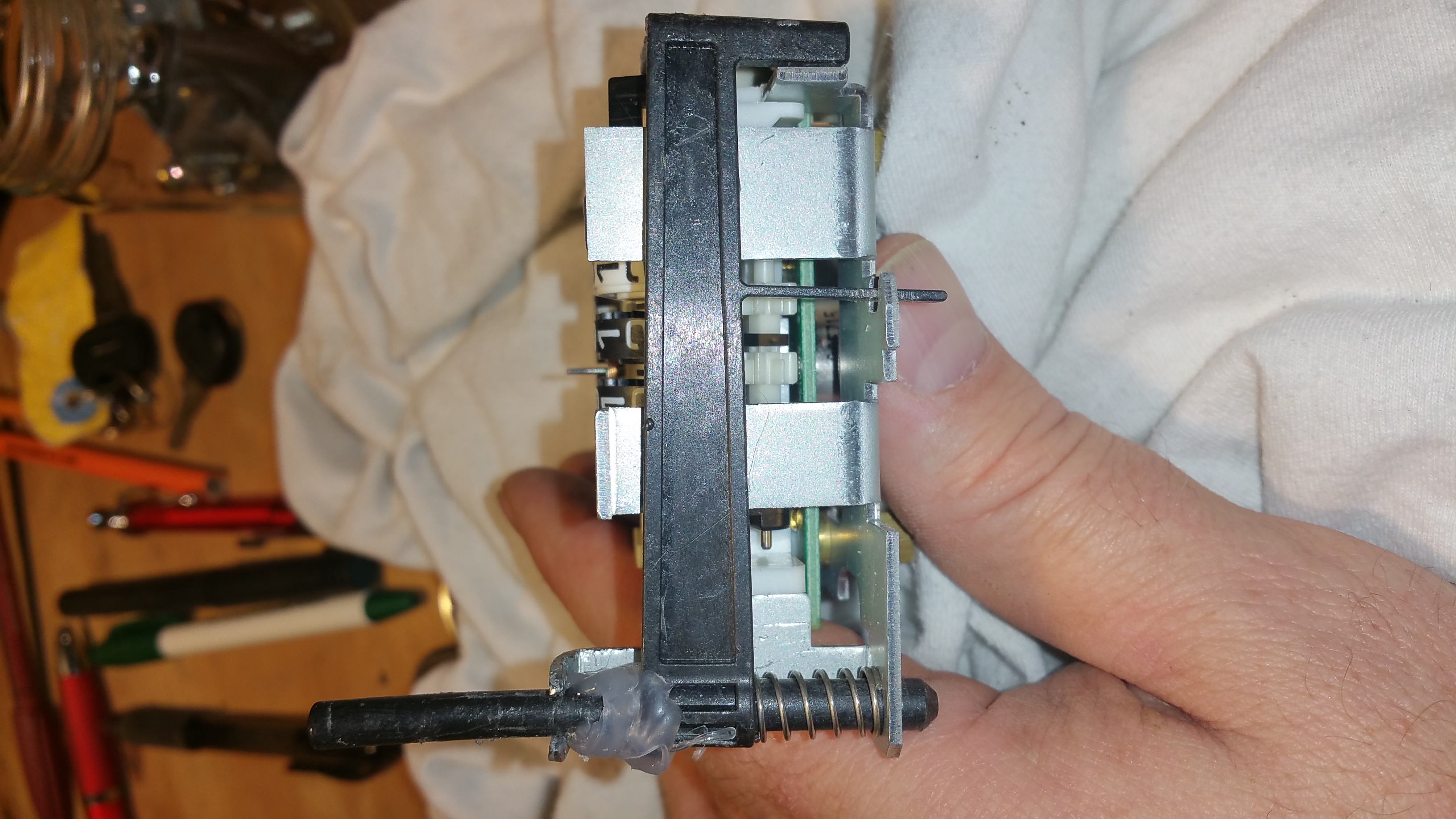

Sorry to resurrect an old thread, but since it's mine, I will.
Concerning the trip arm, for the better part of a year, I've been trying to fix the stem that you push to reset your trip meter. The overall design of the thing is pretty poor IMO, too much stress on a very thin piece of plastic. I found some replacements, but they all had the same break.
So, I've been trying any kind of adhesive I could find to try and get it to hold. At some point, it became personal and I quit keeping track of how much I spent on whatever adhesive it was that I was trying at the moment.
Then last week, I while at work, I was taking a mental break and watching a stupid "life hack" video on Youtube. In the video, some character was using a hot glue gun to glue all kinds of crap to butane lighters and calling it a hack. I thought, "well that's one thing I haven't tried. So I went out, spent 8 bucks on a cheap glue gun and some sticks and after a couple times of trial and error, I actually got it to hold super strong. I've applied force to it in every direction and it won't even think about budging. I now have it back together and it works like a champ.
Thanks. I appreciate it. If you take a look at the pic, you can see that now the arm doesn't go all the way to the top. The horizontal flat arm is designed to hit the metal bracket in the center, which acts a stop.
The problem with that is when that happens, the piece is no longer horizontal. The stem gets placed at weird angle. When you press on it to reset your trip meter it puts a lot of lateral force on the thin stem.
I realize that my glue job looks like a big glob. It's actually that way on purpose. Not only does it provide more strength, but it creates a stop so the stem doesn't travel all the way up. There is enough travel in stem to reset the meter when needed but not enough to put it at a wonky angle.
It isn't pretty but it seems to be doing the job. Also, it's in covered place so aesthetics are secondary to function.
