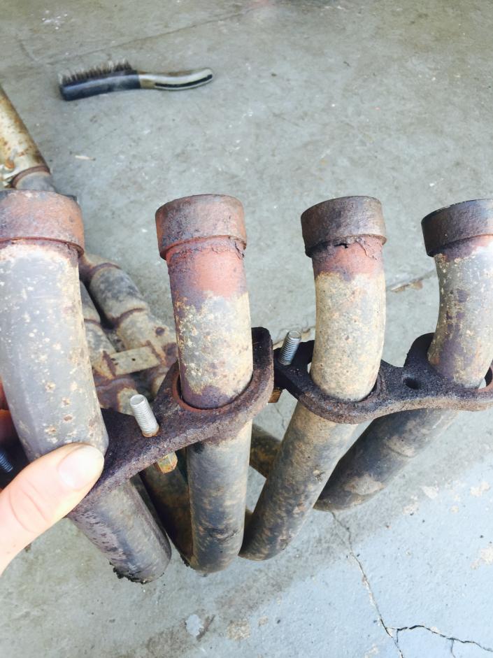

Deff not the plugs already did that stayed at cylinder 2. I did pull off headers today to change gaskets and found a hole a little smaller than the size of an eraser head on the same cylinder making the tick, fingers crossed that's all it is.
UPDATE: SOLVED!!
Ok, so as I said I pulled the manifold off today to change the gaskets. I didn't know what condition the gaskets were in but I figured I'd change them anyway, you know just in case there was a leak. So while I have the manifold out I start wire brushing some crud away to make sure they sit nice and flush against the new Gaskets. While I'm wire brushing im looking at it from the open ends, all the sudden I see light through one of the pipes. Wouldn't you know it's the #2 cylinder pipe. Is this my problem, I don't know. So I run out to the local parts store and pick up some 3000 degree quiksteel epoxy to fill the hole. I do that let it cure (website says an hour, and that heat helps it set better/quicker) so I patch it up and take a propane torch to it to speed it up a little. I put a little grease on the gaskets to keep them in place while I wiggled the manifold back on, fired it up aaannndddd...... Walah, no more God awful tick, why putting the choke on made the tick go away, beats me, but the tick is gone and I'm happy. Now to figure out why I'm spraying some oil from the valve cover. I removed the cover a little to start to measure valve clearances, still had the plastics on and realized I needed to have the plastics off to do it. So I slipped the cover back on, tightend it down. Since then I spraying some small amounts of oil. I imagine it's the gasket pinched or something somewhere.
