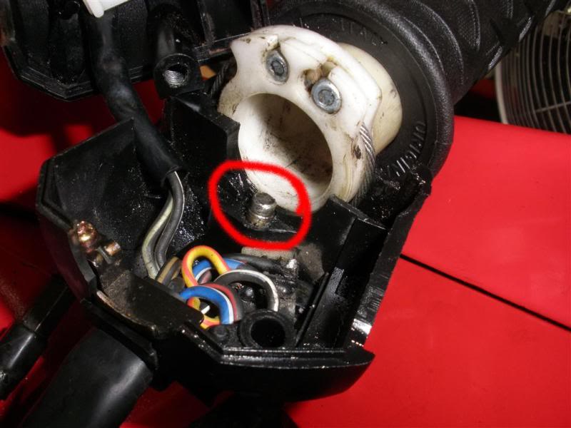

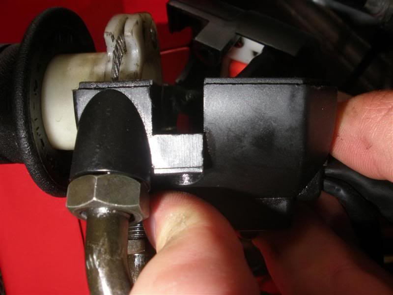

I've had a sticky and heavy throttle since day one with my F3. I decided to do something about it and lube the cables. I finally got them off but now that they're clean I think I may have found the problem elsewhere.
This little metal nub that sets how the plastic housing sits against the bar is tilted. Its hard to see but I did the best I could to show it in these pictures. I think its sitting tilted enough to set the switch housing at an angle and make it press against the throttle sleeve.
Anyone who has these parts - does your little metal piece sit like this or is it level?

That little metal piece clips onto your handlebar, theres like a dent on your handlebar that that little piece goes into to prevent your thing from turning awhile you twist the throttle.

Doh! Completely didn't notice the recess for it in the bar. Thanks for the suggestions everyone. I'm going to take another shot at getting it put back together later this afternoon and see if all goes well.
