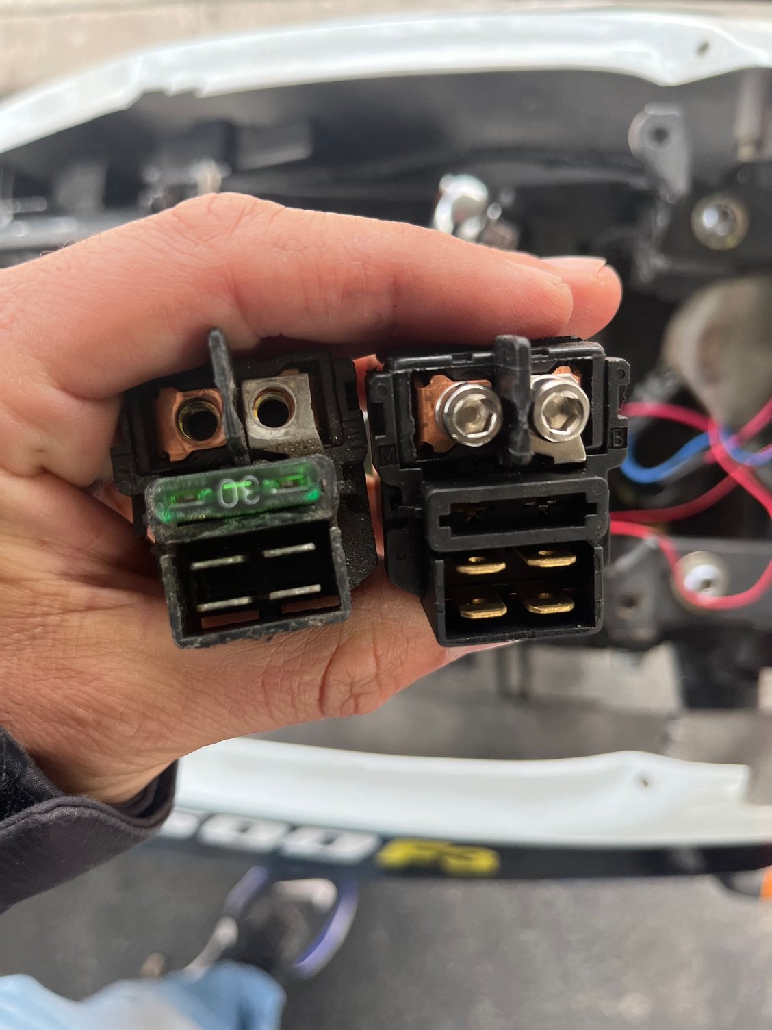

Used a $7 starter relay and the bike turned over. Went and got gas for the line and tried to start again and the clicking began all over again.

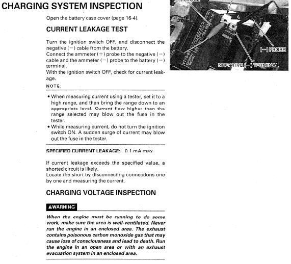

Also measure for parasitic drain when OFF.

by the way the starter relay replacement by Niche gave it a start however the gas was not connected and when connected the gas there was start just clicking. Will try the multimeter and post photos.
