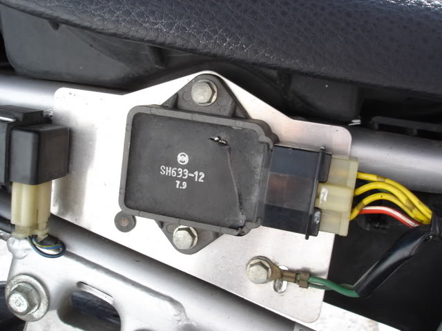

So my rectifier went out I got a nother one but when I went to change it the plug was melted to the rectifier. So I guess I hooked it up wrong. It keeps blowing the main fuse now. Im looking for a pic of where the wires or some one who can help me out and tell me how it hooks up. Thanks 4 the help
Old May 23, 2009 | 11:05 AM
This photo shows where the original wires go to the factory R/R. There is one wire that you can't see and that's hidden behind the top yellow wire. (this R/R is bad by the way)

cool thanks man thats just what i needed i think

Yes, a dielectric grease can help to keep moisture out and the connection clean. These types of connectors are hard to clean because of them being internal. Using a screw driver to "pry" the connections closed so they provide a tighter connection will help. The less resistance through this connection the better. I'd recommend checking this connection on an annual basis. Most of the heat generated in this area is the device itself, hence the large metal plate that it's attached to. Unfortunately, it's not that effective at cooling, and the unit ultimately fails. On the connector above, there was no corrosion or discoloring of the connector from heat. However, you can see it was hot enough to melt the black insulating goo that they cover the electrical components with. Suzuki's voltage regulator/rectifiers have much better heat sinks on them, but that's another thread.
