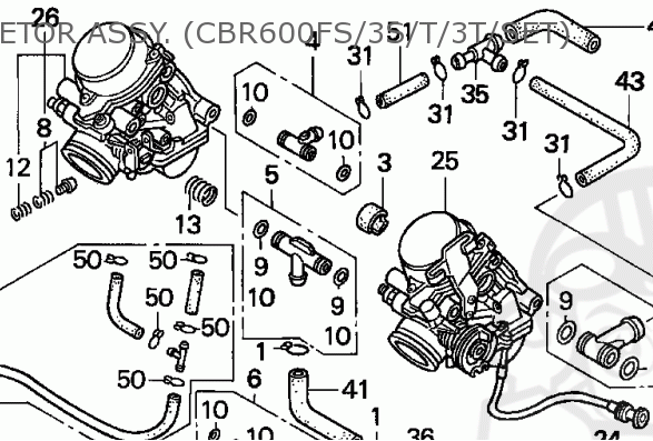

Ive got fuel gushing out of the o rings between the carbs so i need some new ones. Does anyone know their sizes of these? (im in the EU so mm preferably=) )
the part im looking for is part no. 9

Don't know the dimensions, but EU supplier seems to have them.
https://www.cmsnl.com/en-gb/honda-cb...c_16039mz1790/
or these as it was a common parts with the Blade:
https://www.ebay.co.uk/itm/275530488...Bk9SR4Cl4bzwZQ

Fuel is 1.5mm x 8mm if memory serves, air is 2mm x 8mm. There are kits on eBay though with all the parts.
