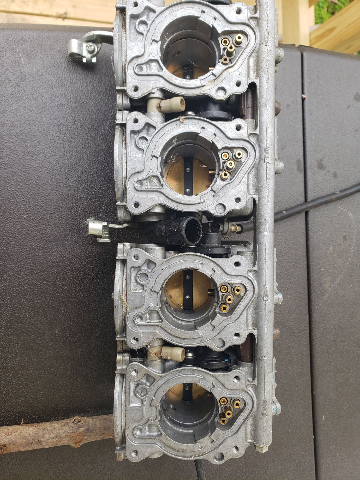

Just watched a video of guy syncing a set of carbs on an old Honda he says he removed the vacuum lines and capped them just curious how is that done? I will post a picture of them a bit later and if you guys will give me your opinion

From on side the butterflies are stuck closed
