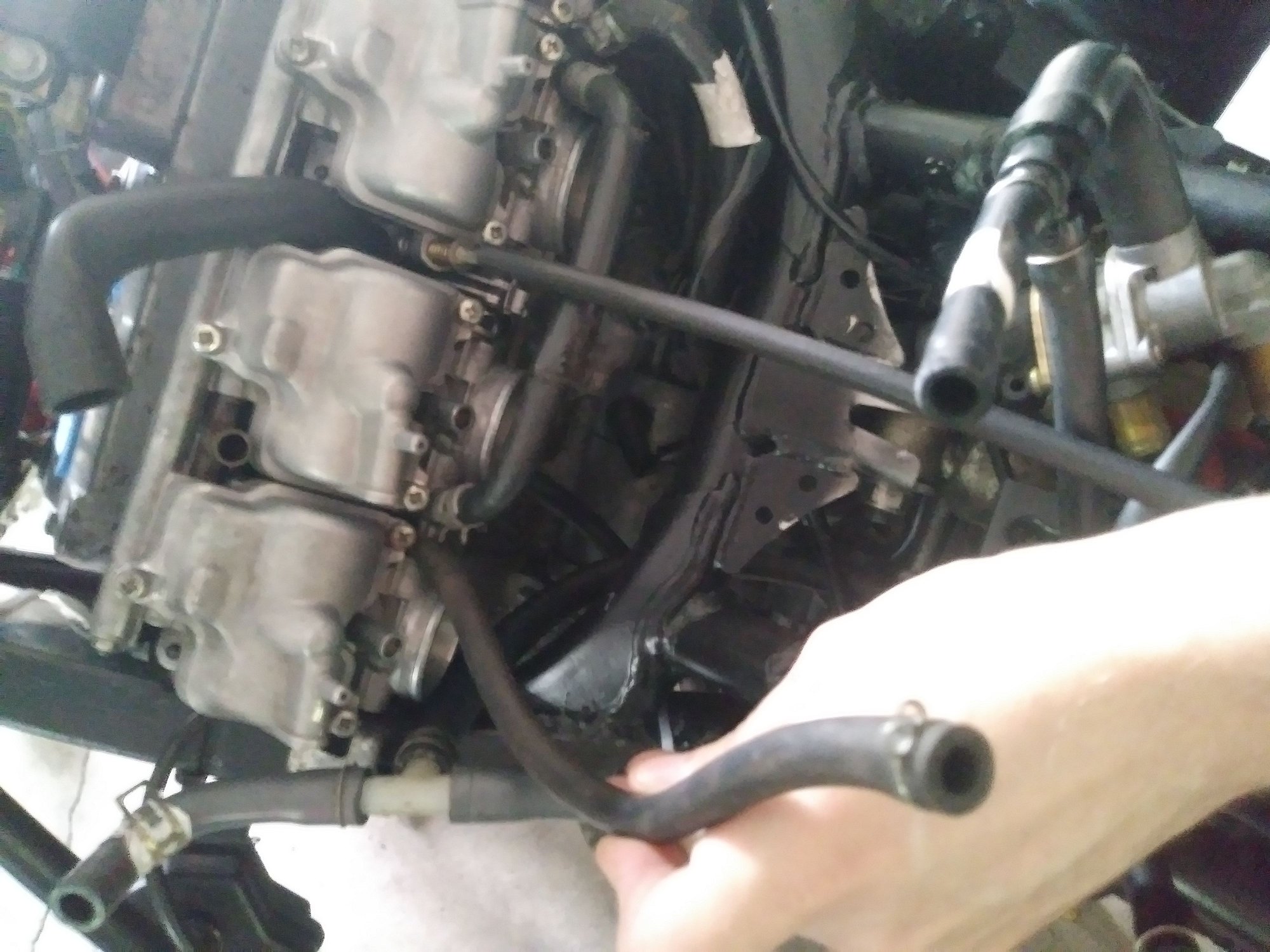

I am very new to the forums but i recently have been doing some maintenance on my 97 CBR 600F3 and i have 2 hoses that i cant seem to figure out where they went, any help would be great. i should have recorded myself taking it apart but hope someone here knows what these both go to.

Those are coolant hoses that route through the carbs.. I'm not around my bike right now but will provide pics later if neeed.

Thank you very much for the reply, any pics would be extremely helpful if you are able to supply them, This is my first time messing with the hoses (as you could probably tell) so i am a little lost.

Update: I figured out where the hose goes from the first picture. still not sure where the one on the second picture goes though.

Sorry I haven't had a chance to give you the pics. Life had other plans for me this weekend. It looks like you got the left side figured out. The one on the right side connects to the thermostat valve. It's located in the center of the bike kind of under the carb area.
