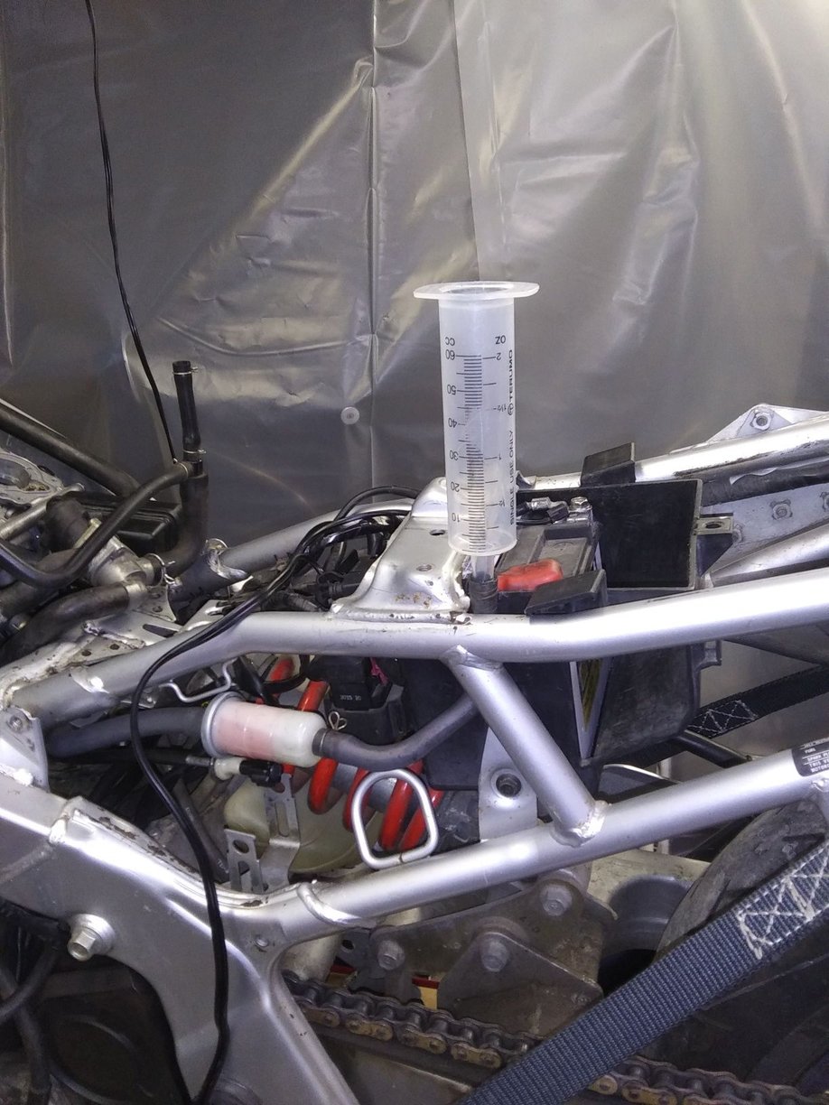

All new internals were installed? Most of the aftermarket parts that are cheap are garbage.The floats, the jets and needles are all garbage.I'm not sure what parts were replaced but if the flooding problem was not there before the parts were replaced, it's most likely the problem. Sounds like the carbs need to be removed and rechecked. You don't need the fuel pump or gas tank installed to make it run. I just went thru my carbs, got it running, no fuel pump or fuel tank. This is what I used a fuel tank. You can also shut the petcock off so once the carbs are full no more fuel will get to the carbs and cause flooding. Let us know how things work out.-Mike
