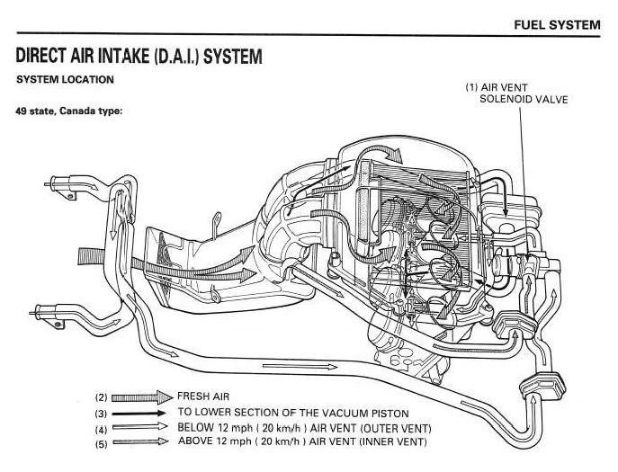

What's the deal with the speedo cluster unplugged and it effecting the way the carbs work? I'm in the middle of sorting thru multiple problems and had the speedo cluster out to try to repair the trip odometer reset ****. Can anyone explain this? Thank you-Mike
Old Feb 22, 2021 | 11:12 PM
Yes, there is a signal that comes from the speedometer at about 12mph that switches the airflow from those small little Funnel looking things below the headlight to an alternate path. It's called the Direct Air Intake System.
