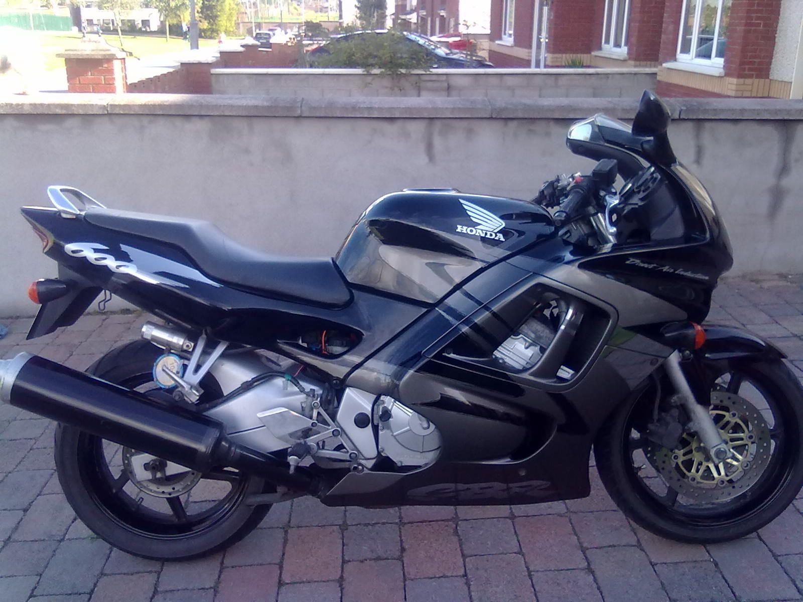

Old Feb 26, 2021 | 02:29 PM
Deaconblue's Avatar
Joined: Feb 2021
Posts: 13
From: Cork
Default F3 issue
Then and now 😎
Old Feb 26, 2021 | 03:08 PM
Posts: 2,568
Spooky, I had exactly the same Colour F3, bought in 98 and traded in for a silver F05 in 2005 that had 22 miles on the clock!
