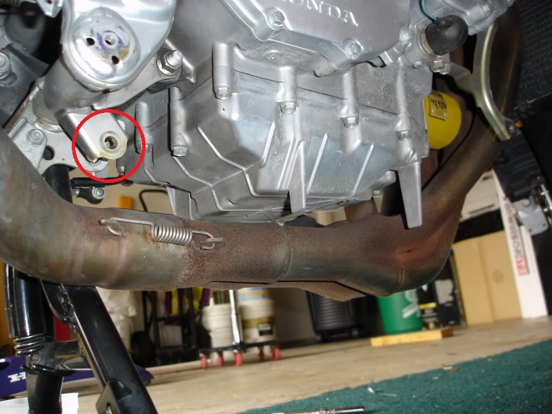

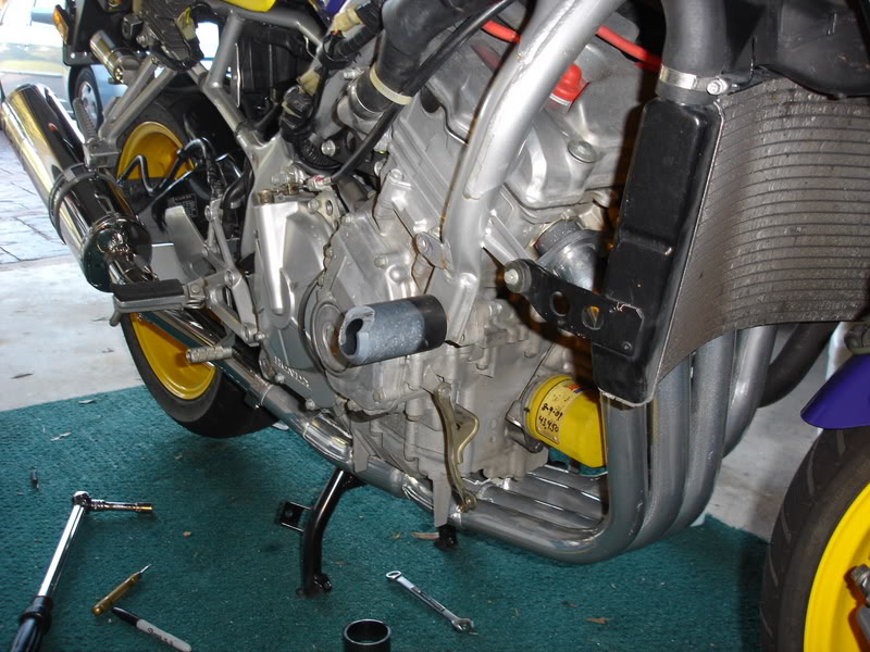

I never had to do anything unusual to change the oil filter on her bike with the aftermarket exhaust or with the factory header on it. Are you using aftermarket filters on your bike ? There are 2 different sizes from Purolator that will fit on the bike, but one of them has a longer body and probably would interfere with the header during install/removal. I use the longer one on my 1000F, but the standard size on the F3. Here are the 2 part numbers one for the F3 and the other I use on the 1000F. Both of these filters have the same thread size.
Puralator PureONE PL14612 (this one is about 2.5" long)
Puralator PureONE PL14610 (this one is about 3.25" long)

Yeah the headers you have in that picture look different than what i'm speaking about... but what you're saying sounds right. Its probably the longer filter. Basically it gets wedged between where it screws in and where the headers are and I can either completely destroy the filter to get it out or loosen the headers and move them out a bit then it slips out. And yes, it does have aftermarket headers, but the previous owner had installed them. I will post a Pic as soon as i get a chance to show you guys what I'm talking about. I really appreciate the replies though guys ! Thank you !
- Seb
Old Jan 2, 2012 | 02:30 PM
The photo in the above post was of the OEM headers that I was putting back on the bike. They've been Ceramic coated, which is why they look so nice. This is the only photo that I have from before with the old V&H headers. It unfortunately doesn't show a clear image of the filter to header clearance.

Yesh yesh yesh !!!! Thats the pic i was talking about ! See how header 1 and 2 overlap a bit instead of being parallel like the oem ones ? Thats what i speak of ! it gets in the way of my filter so frustrating -_____- it's all good though, I think i may just get a new exhaust system and then that'll solve the issue lol. New* exhaust so i can change the oil ! xD
