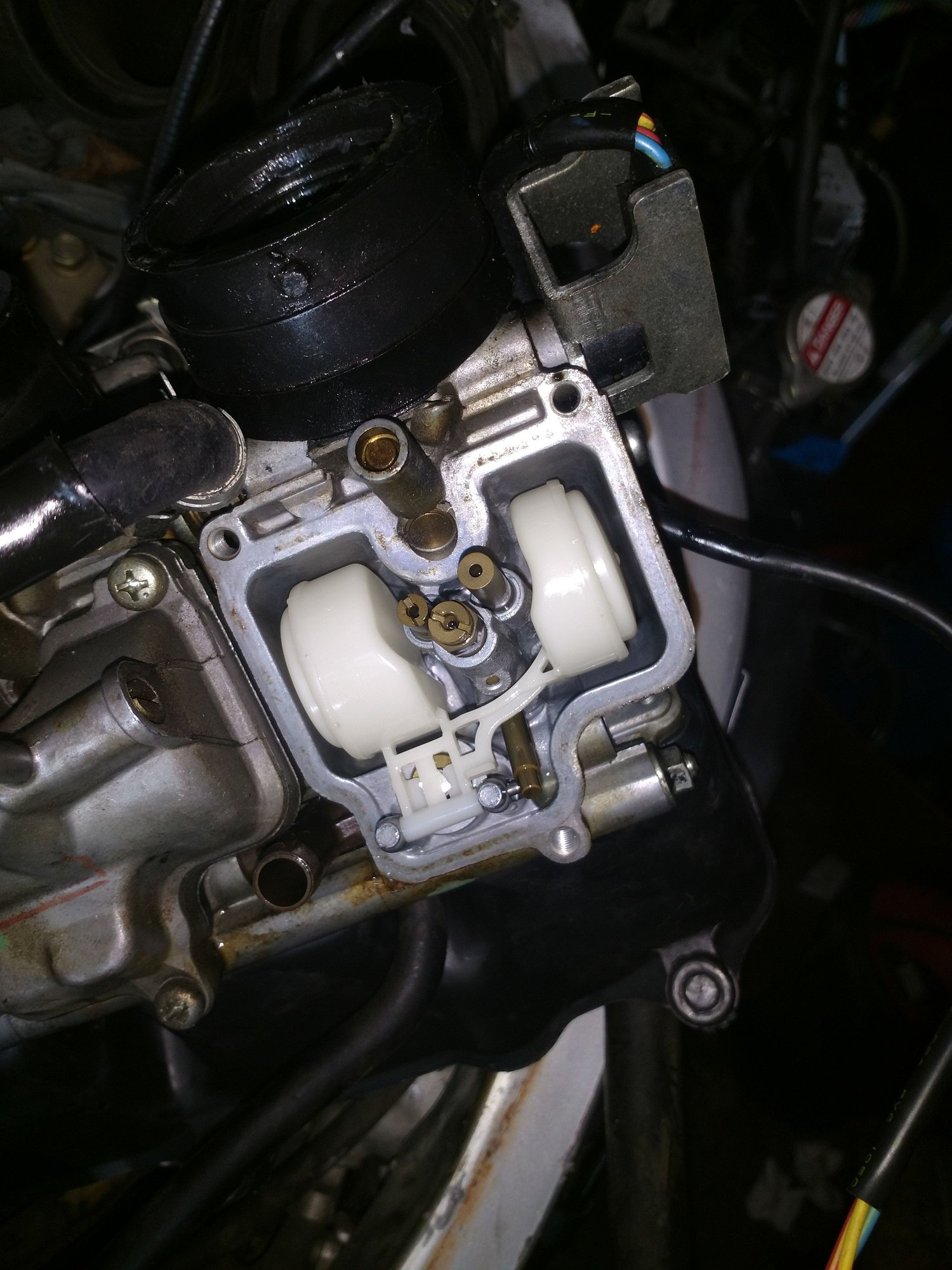

Pretty clean I was suprized, my jets were completely plugged tho

Yep, those bowls and floats look pretty good. From the pic, the bowl gasket doesn't look bad. While you are cleaning out everything I would clean the flat surface of the bowl where the gasket meets, it's not bad so it shouldn't take much.
