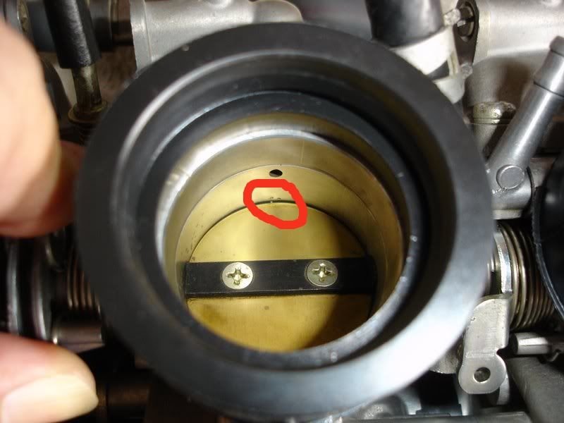

Why did you change the jets, I would go back to stock but make sure they are absolutely clean along with all the 'holes'
Courtesy of 'IDoDirt'
