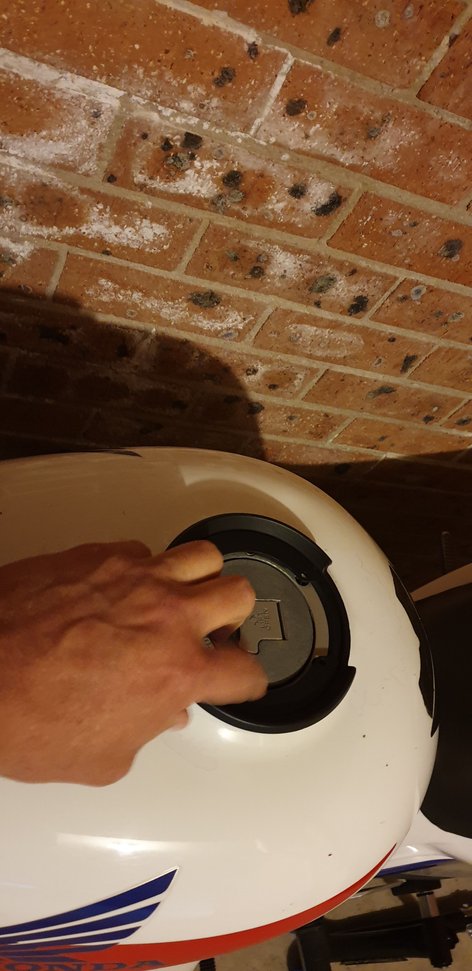

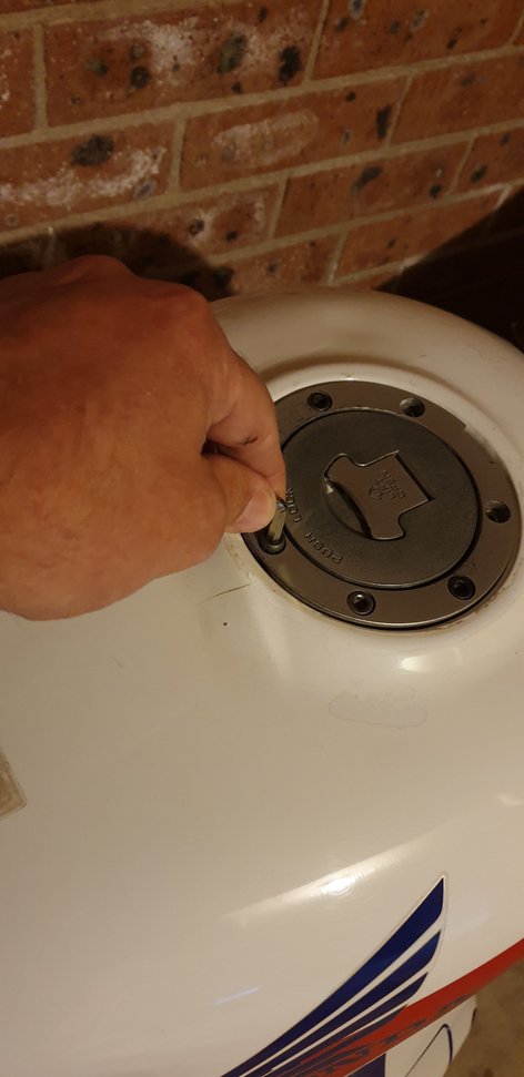

Remove 3 of the original fasteners
Fit the ring and adaptor with the 3 supplied fasteners

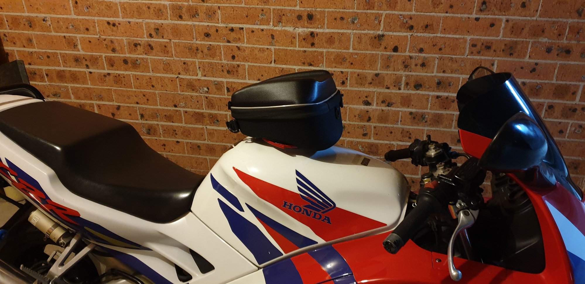

Fit the bag- less than 5 mins total

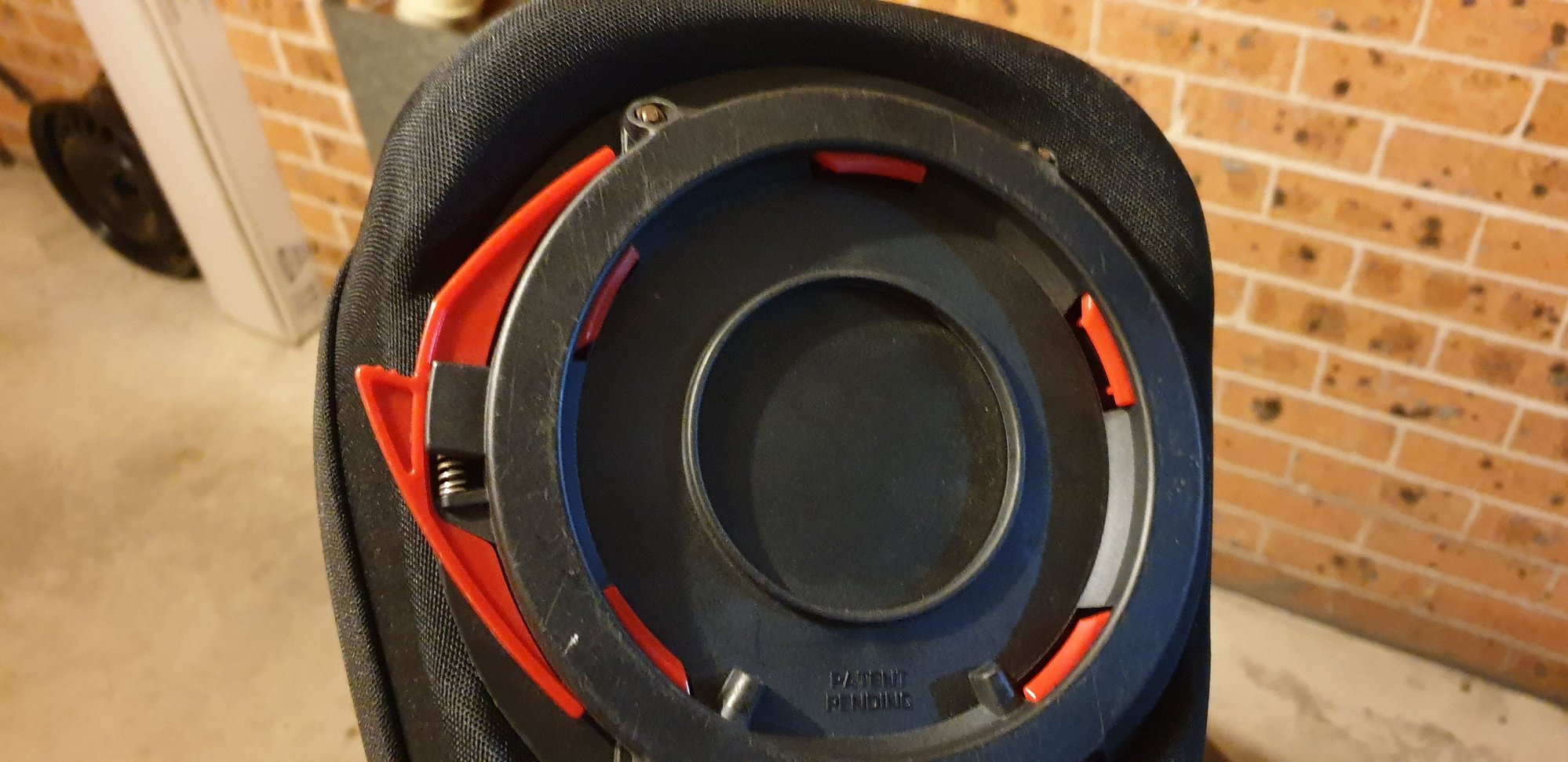

The base of the bag with the retaining clips and release

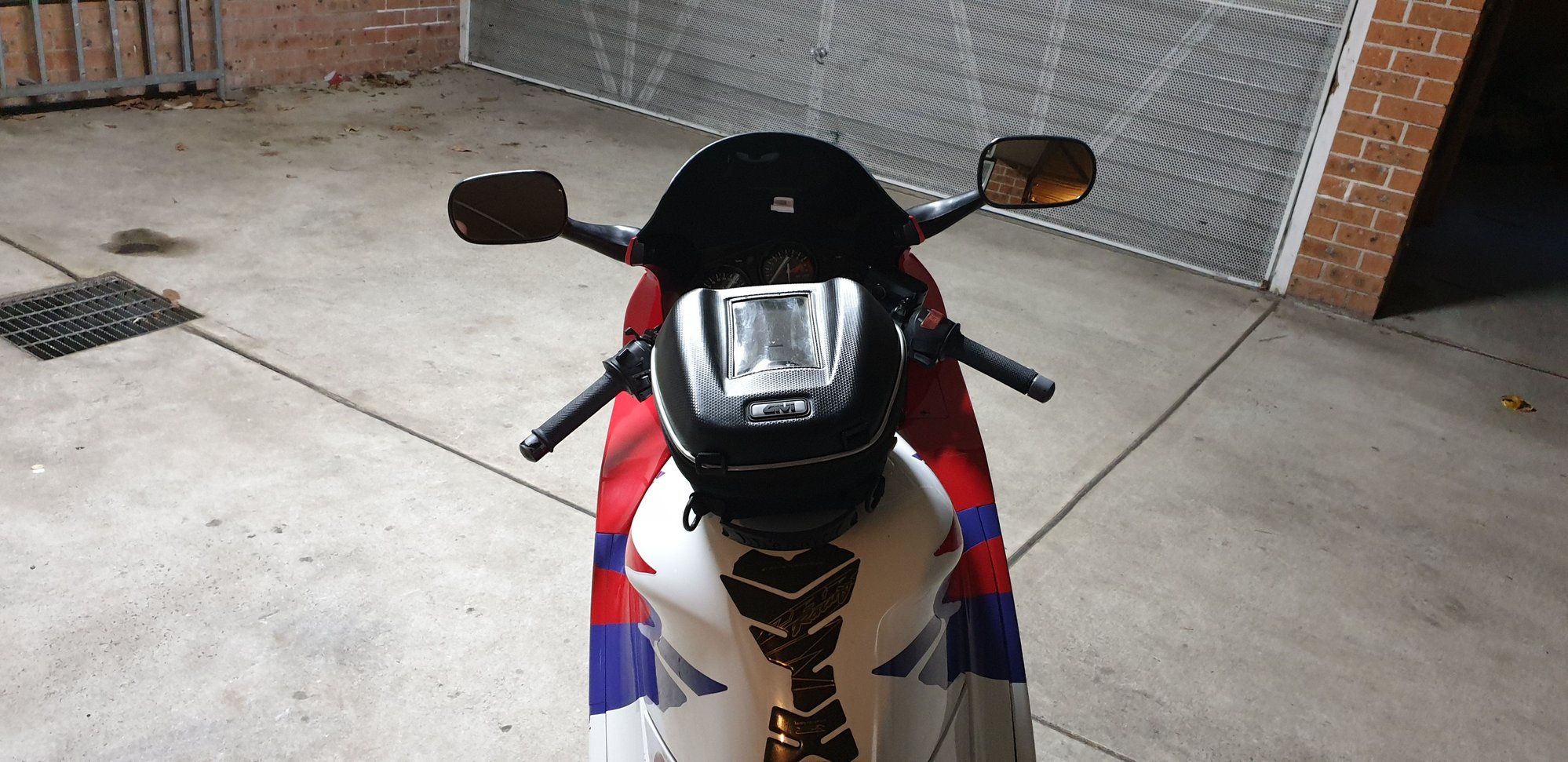

The 4 litre bag doesn't get in the way of gauges or bars as some bigger bags do

Update: Looks like I may have to trim down slightly- as a "husky" gent the tank bag doesn't allow me to get as forward on the bike as I like for the corners. It would be fine for a relaxed cruise but restricts movement a bit at the moment. Off to the gym!
