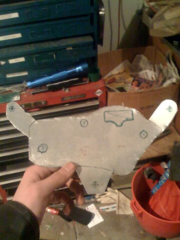

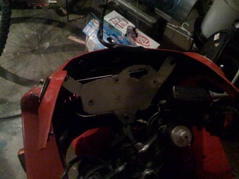

@ grizzly: I think $150 is a pretty reasonable price. MSRP is well over $600(not the $1,100 your local shop wanted). I actually have a set of F3 gauges I'm looking to get rid of.. and I am asking $150+shipping. If interested, PM me and we can go over details.
@ ubc90: Bullit70's link is the same tutorial which got me involved in the swap. If you're going to do it and have any doubts, it's the reference to use. Just make sure that, if you live in the states, you get a set of F4i gauges which read Fahrenheit and not Celsius like I did! Also, be gentle when removing the F3's temp. sending unit. I sheared mine in half and had to figure out a way to get the rest of it out of my bike so I could proceed. What a nightmare!
For anyone interested in how to mount the gauges, you can do as SHugo did.. or you can do what I did. I took an old vanity license plate and a set of tin snips.. and started cutting away until I had something that worked. Here is a pic of the mount prior to being drilled or spray-painted:
