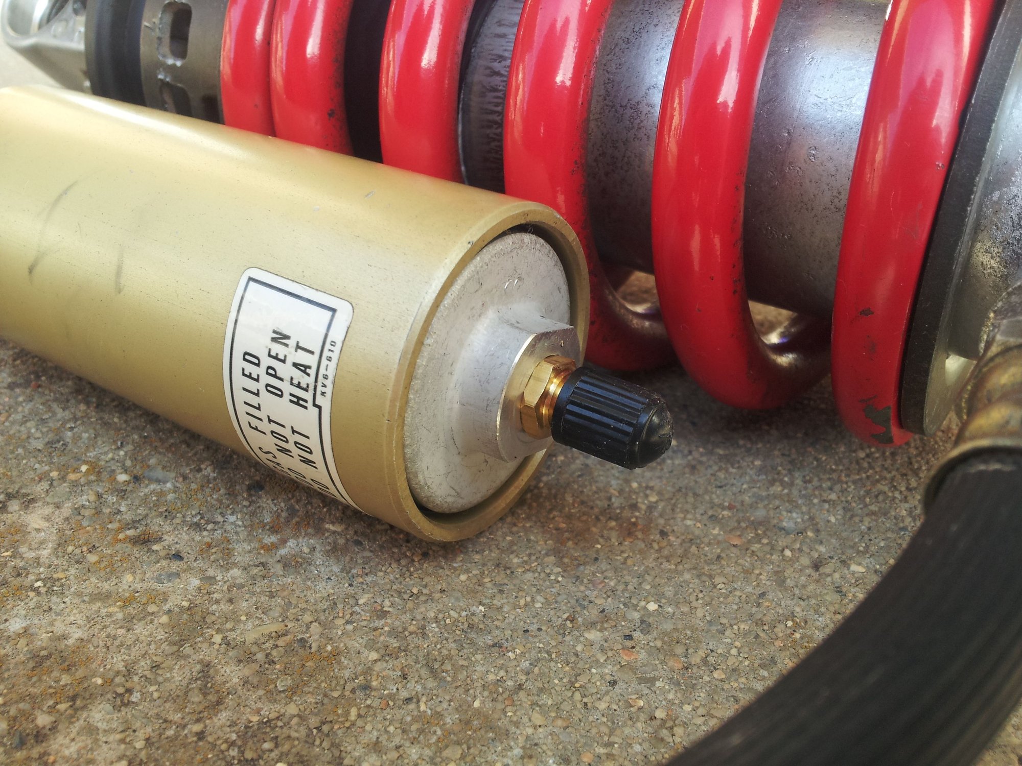

you can re-fill your stock res by installing the Racetech end cap.
Replaces the stock blank end cap with one that has a filling port.
Had mine done by my local shop. Cant remember the price, maybe around $100
Old Nov 12, 2017 | 08:14 PM
gorn's Avatar
Joined: Jan 2017
Posts: 30
pic

Yep. Looks nice.
