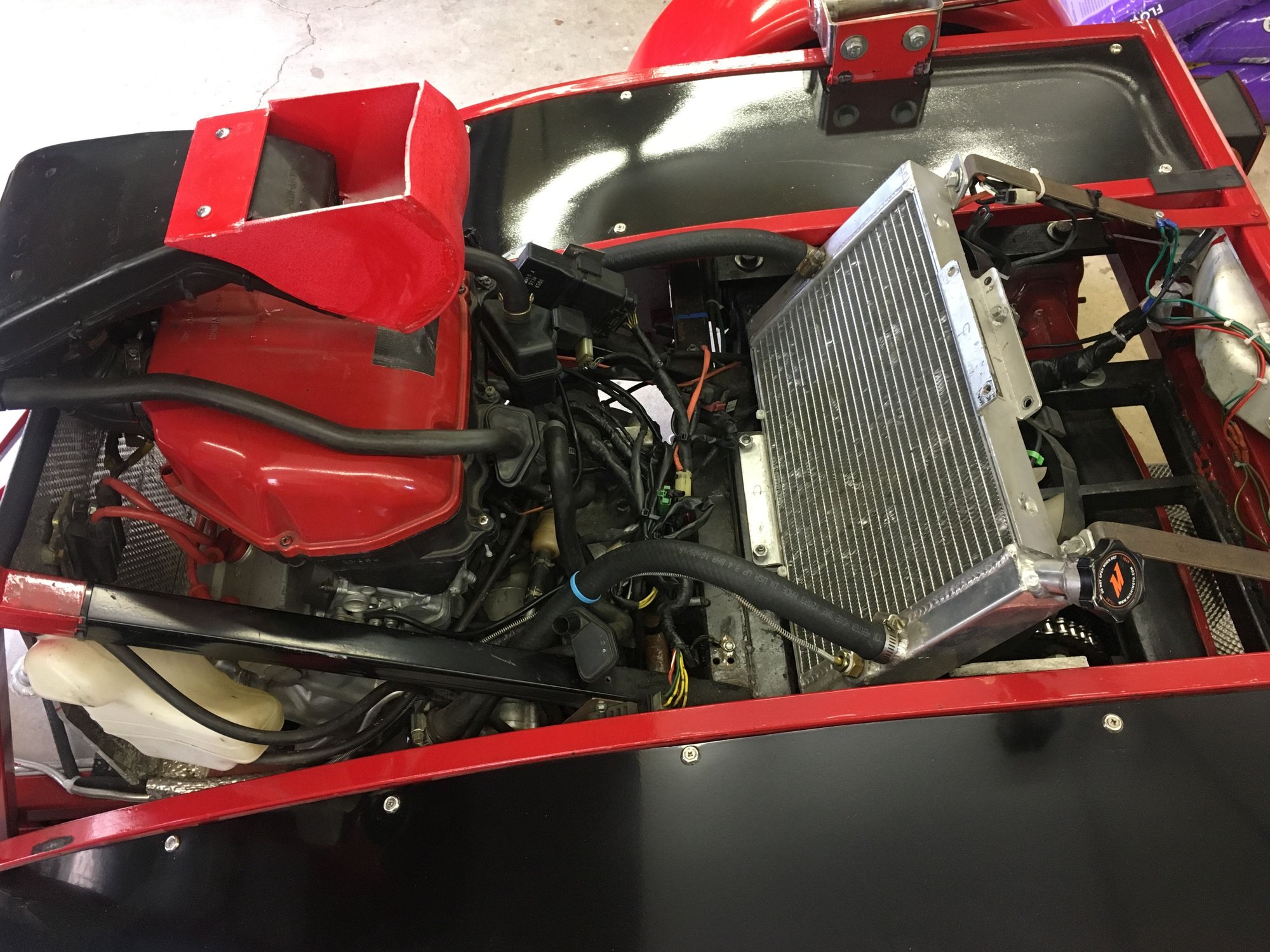

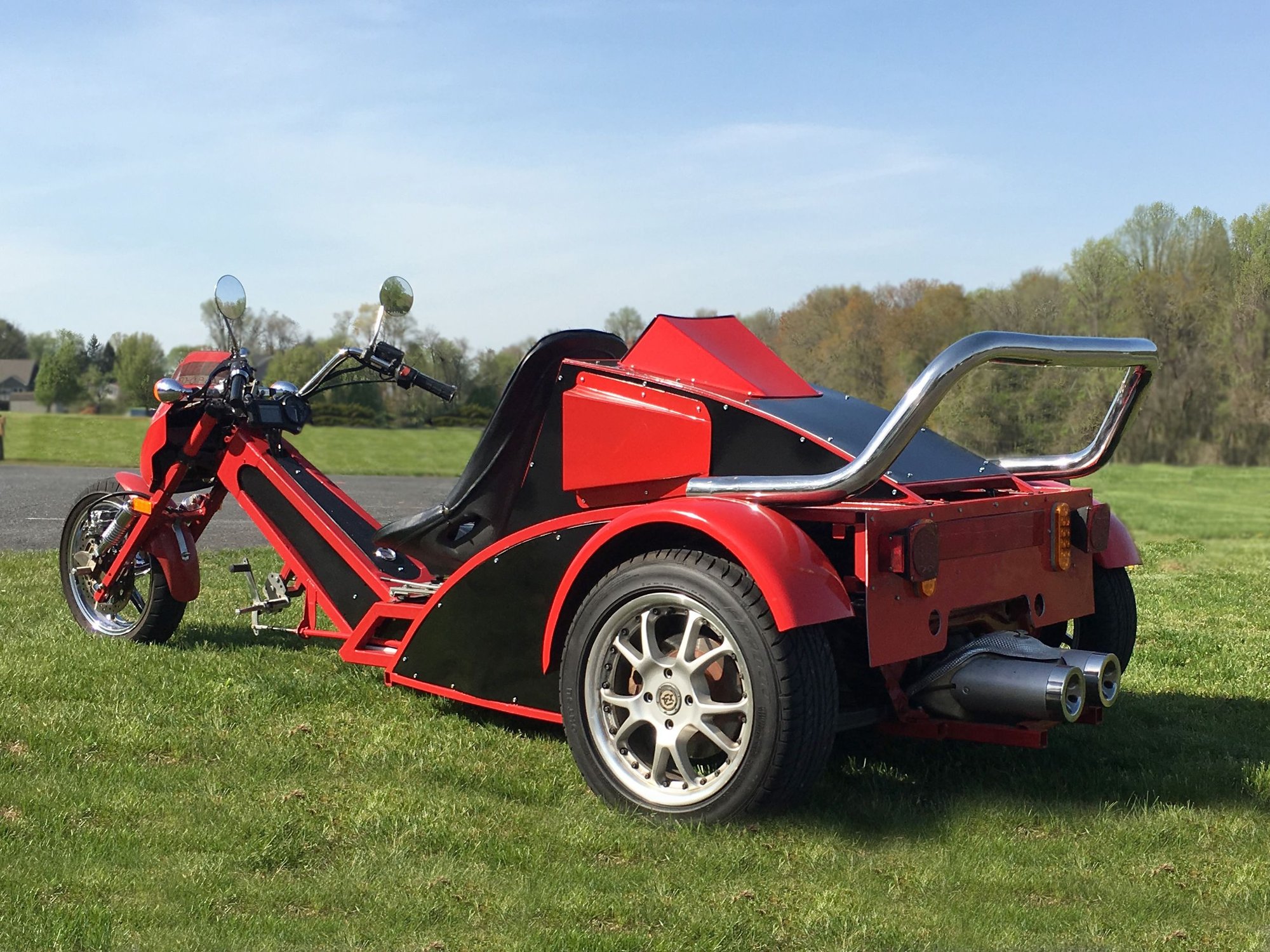

I built my Mid Engined Trike with a 98 F3 engine and left this temp gauge swap-issue as my last fix.
I have spent way too long tearing my wiring harness apart looking for issues.
I have added a pic of engine bay and full size.
again, thank you.

That's a nice project!! I can't be too sure that's the issue, I am new to motorcycles for about a year. I bought my f3 with the guages already installed and I know that's how mine acts maybe another member could confirm.
