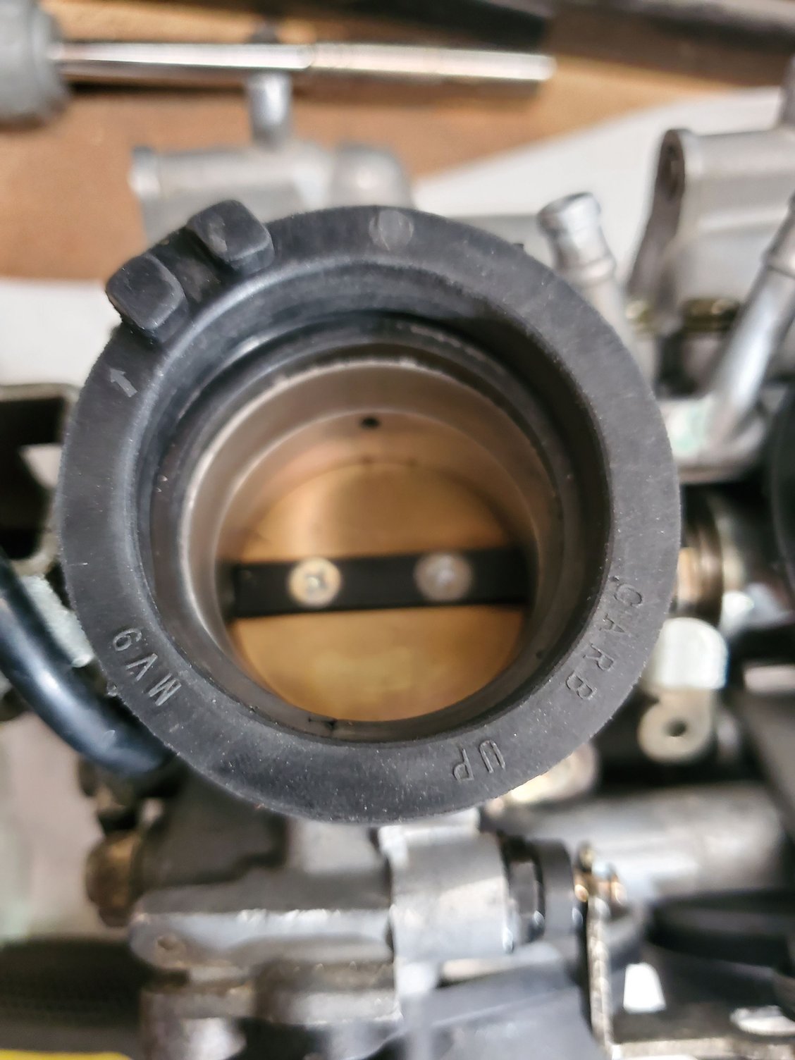

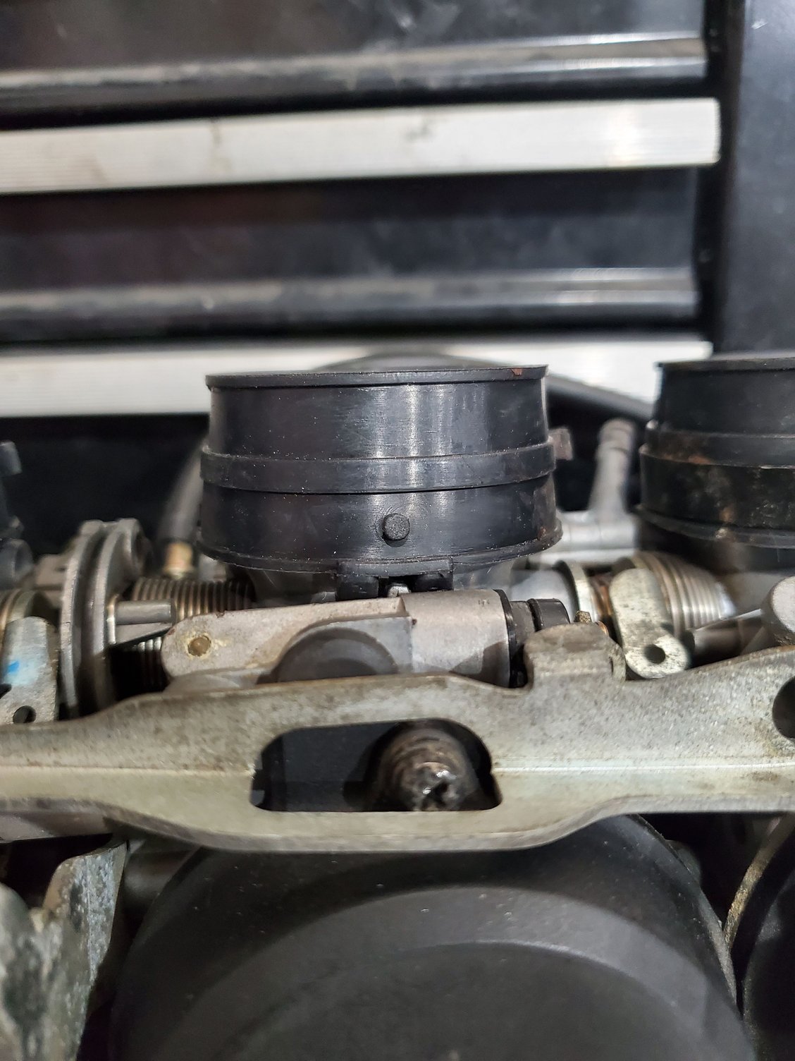

Bought some new boots for my f3 off ebay. When I get them on the band screw isnt long enough to reach the square nut. Should I just get longer screws? Also, when I slip them on with the "carb top" side against the carb they kinda flare out at the bottom. Could they be made backwards? Pictures of them sitting both ways
This side should be against the carb but flares out and the open hole is smaller than the opposite side
Flared out
Installed opposite of what its supposed be. Not flared out

Pretty sure these are not the correct ones for your carbs. The screw length is the 1st indicator. There should be ample slack in the screw. Also the bulge your picture shows is incorrect as to fitting. There should be zero bulge. New boots should be snug but require no excessive force to install.

You're right. I figured it out as well. These are mv9 for a f2. Mal is for the f3. Wrong insulator boots
