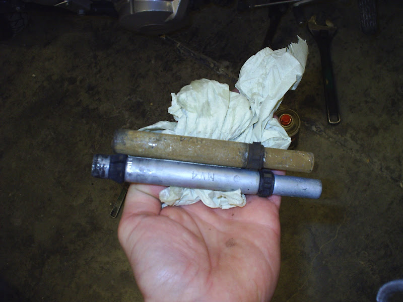

Just wondering if this requires a new clip on. It is not just the bar end that broke off, the threaded tube that the bar end screwed into also snapped. These were the best pics I could get with it.

So, new clip on or can this part be replaced?

The part can be replaced, I had to do that once. It was broken and appeared to have been so a long time before I got the bike.
Assuming you have the stock bar weights (the part inside the tubes),
they look like this:
Although one of mine was in good order, I replaced both.
So, assuming you manage to get it out of there, it's just another replaceable part
Edited to add part numbers:
53104-MV4-000 WEIGHT B, HANDLEBAR
53105-MN4-010 WEIGHT, HANDLEBAR
53106-MJ0-000 RUBBER
53106-MV9-000 RUBBER A
53108-MJ0-000 RING
