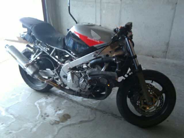

Here is my bike. Its a long story on its condition, and i may get around to a rebuild thread sometime. FYI that is the correct location for the gauges.

Yea I am currently geared at 16/45. I have a F4i front end on it so I have compression dampening adjustment. A jet kit. Some nice new Bridgestone BT-003RS tires 160/60 & 120/70. Rear shock is the only upgrade that i am still wanting to do but i don't have the funds for it yet. Thanks for the heads up on WERA I had never been on that site, tons of F3 parts.
