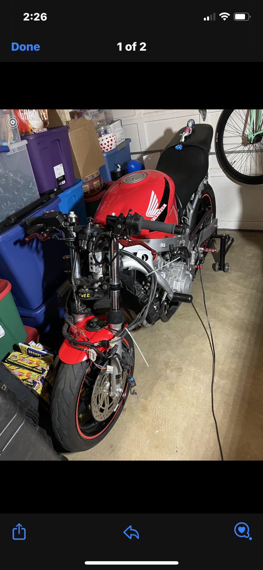

Building a street fighter! Wanna change my cluster! What yr f4i can work on my bike?
I removed everything!

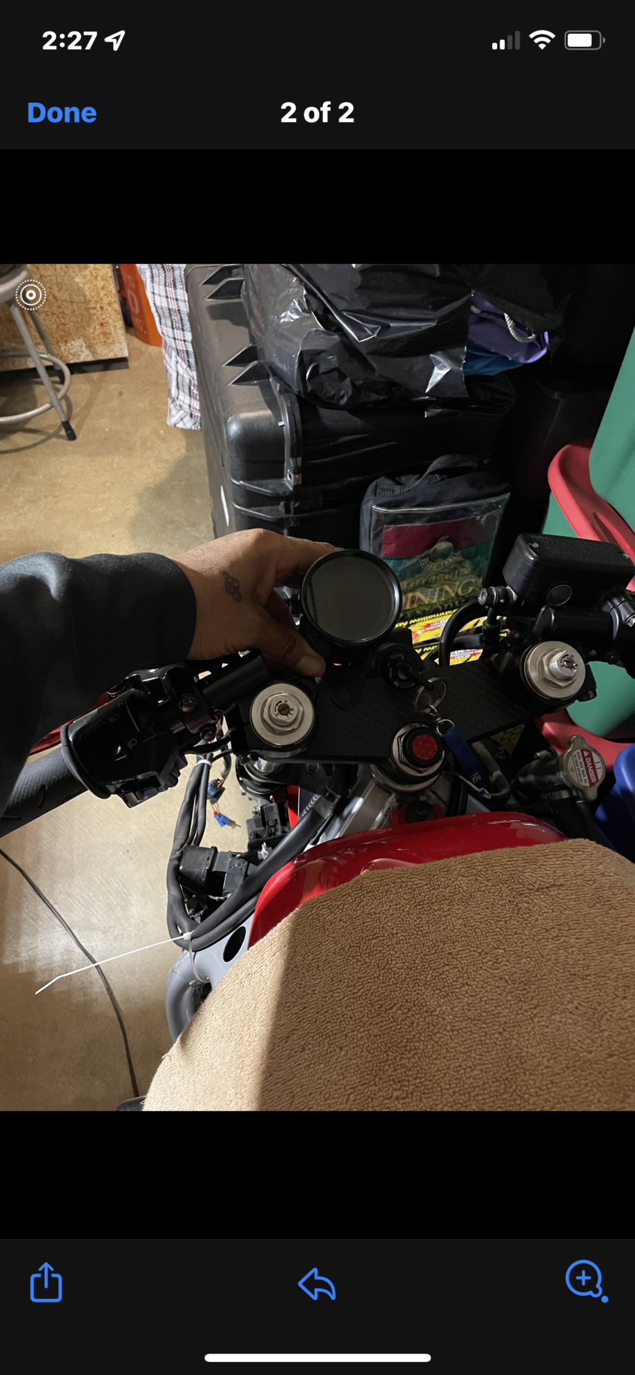

This is the cluster I just brought but I’m open to any ideas anybody has on a cluster! I’m making a street fighter

From all conversions I've seen, any year F4I cluster will work.
Where are you located? I ask in case you have all of the OEM plastics from your bike and are interested in selling them.
*Edit - You'll also need '98-'99 900RR temp sensor, and perhaps a speedo healer. Sent PM regarding plastics/fairings.

Buy a speedo healer to the 600f3 or the 900RR?

Sorry last message sounded crazy! I’m I buying a speedo healer for my 600f3 or from a 900RR to go with the temp sensor?

You'll need the '98-'99 CBR 900 RR temp sensor/sending unit, otherwise the temp gauge will flash 257. You'll only need speedo healer if the speed isn't accurate.
