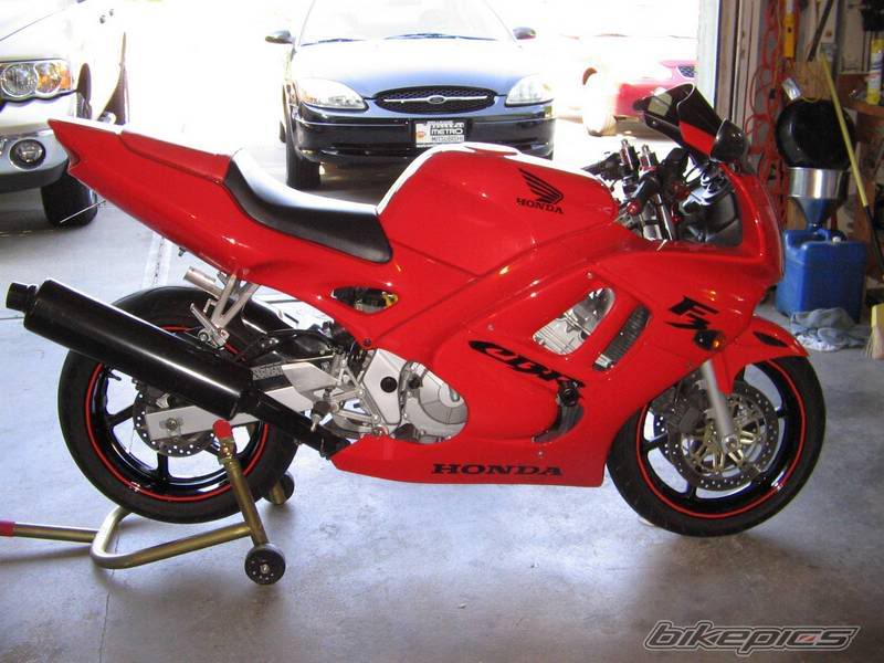

My bike was dropped an inch in the front and raised in the rear with the F4i shock. All you need to do it drill out the fender mounting holes so you can slide the fender up a little. The rear of the fender will rub alittle and eventually wear down. That is the only downside to this.Other than that the bike handled great with this set up. Here's a pic all said and done before the exhaust and a few other minor mods.
