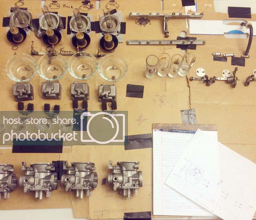

Mixture screws ONLY adjusts idle mixtures. Makes no difference after you crack open throttle.
Yeah, need to disassemble carb more down to every single last nut, bolt and individual component. If it can be taken apart further, do it. Scrub everything with brushes and PEA-based fuel-system cleaner. Spray “carb cleaner” no longer work due to removal of chlorinated compounds. Might as well use pee which will work better because it has ammonia.
Don’t forget to scrub out secret hidden passages inside carb body. It’s areas you can’t see that hides worse clogs. Some of those passages have right-angle turns that traps stuff easily.
Ultrasonic soak everything. Micro soda-blast all pieces before re-assembly. Replace ALL rubbers: fuel-rail O-rings, float valves, float bowl seals, pilot-screw O-ring, even slide-diaphragms (this may be your problem).
Set float levels and verify with external wet test. Sync with manometers when installed.
Many, many people have had to pull their carbs 4-5x for ever deeper cleaning before it was sufficiently clean back to factory-fresh levels. One guy had to pull them 10x!!! I recommend doing full-restoration job from beginning so you only have to pull them just once.
