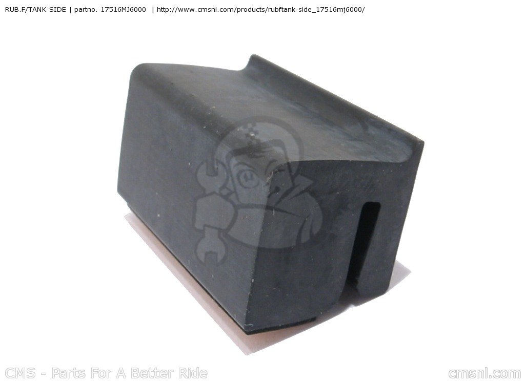

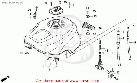

Old Jul 18, 2009 | 08:13 AM
SJN's Avatar
SJN
Posts: 100
Part number for the original rubber is 81214-MW0-300
Attached Thumbnails tank goes a bit left/right, normal? (dump question)-rub-f-tank-side_big17516mj6000-01_24d7.jpg   tank goes a bit left/right, normal? (dump question)-fuel-tank-93-95_bighu0320f1400a_5bbc.jpg
