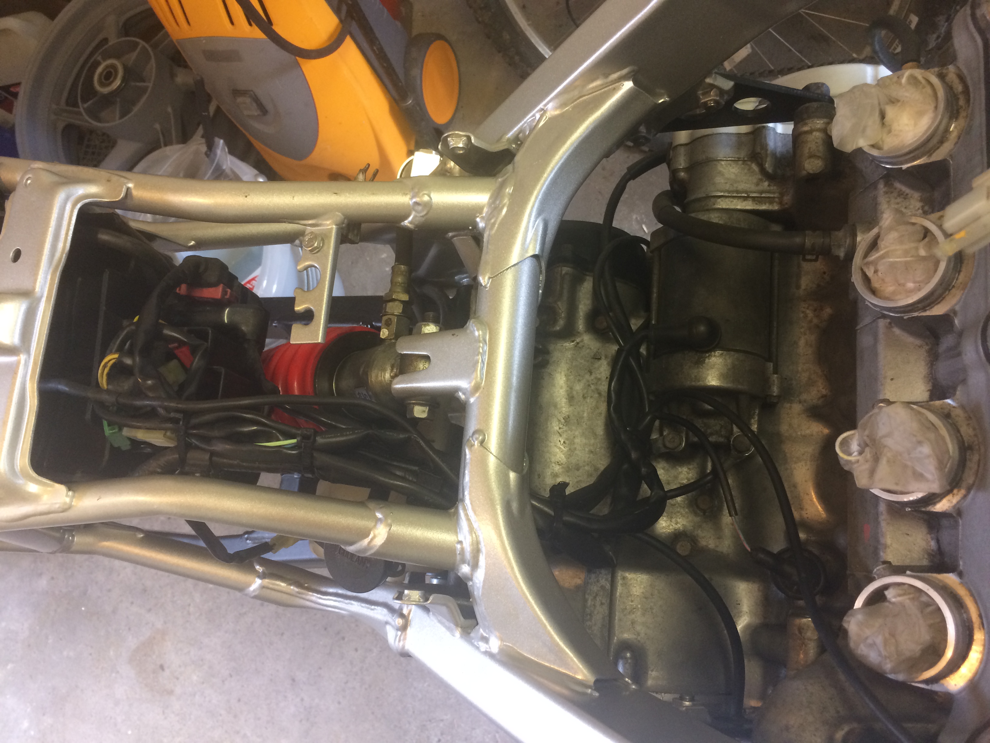

Well the project has finally moved on....
I decide to just clean the engine as I know it runs OK and if I started messing with it the project would never get on the road. I plan on rebuilding another engine with a few tweaks in the winter.
I have used a f4 rear shock as mine was knackered and for £35 it was a cheap upgrade. Having searched on the internet I cant see how the shock will raise the rear by the large amount some people say as its only 15mm longer that the f2. I know the length of the swinging arm makes the change greater but I cant see it making that much of a difference ? unless you guys know better. The one problem I have had is that the reservoir hose hit the coolant bottle so I have had to turn the shock so that the reservoir sits on the left of the bike. I still have no idea how I will mount it.
