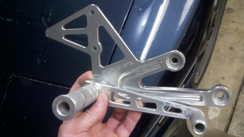

Ended up spending some money on something I wasn't planning on, I couldn't pass up the deal...

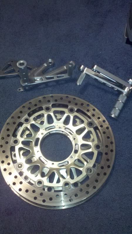

Also got my rotors in

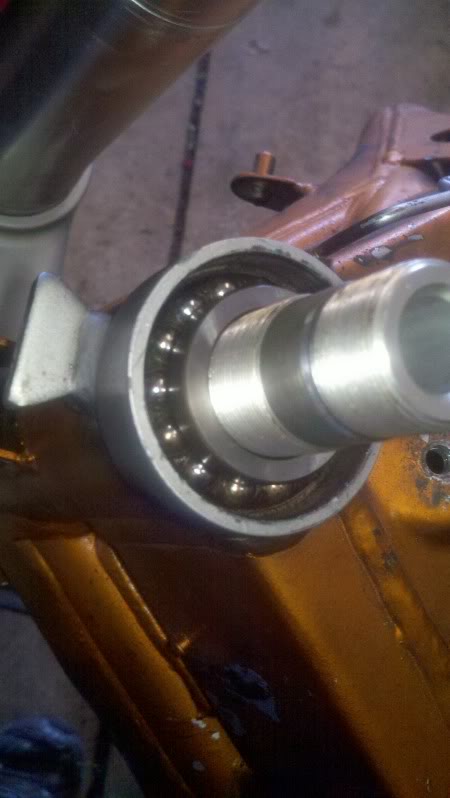

First off, for anyone with an F2-f4i reguarding a front end swap, they all use ball bearings instead of roller bearings like the RR's. The 954RR front end IS a direct swap for these bikes, The lower triple I picked up had the bearings with it and they dropped right into the F2 bearing seats. (see pics below) Although I did see one 954RR listed that had roller bearings with it, not sure what year it was.
I really searched around for the last couple months to get good deals on everything, I justed picked up the few 1000RR parts because I just personally like the setup of those better.

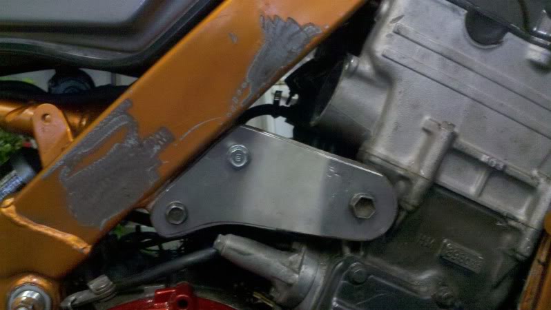

I also an finishing up the rest of the mounts:

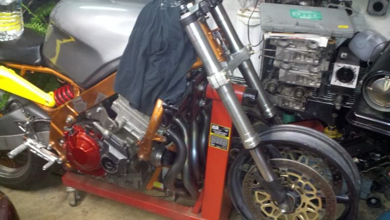

Subscribing, nice build so far. Is that CCT going to fit in, or are you going to have to notch the frame?
