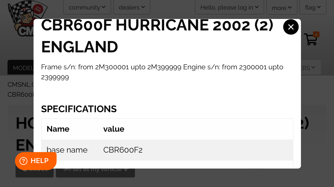

In Europe, they had different naming conventions. A 2002 CBR600F in England is known as CBR600F2.
