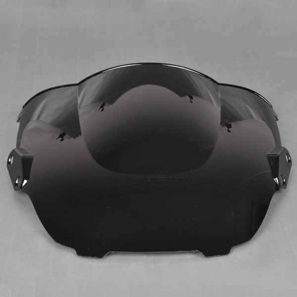

Default Bubble screen
Thinking of getting a bubble screen for my 1997 f3, do these actually make any difference??
