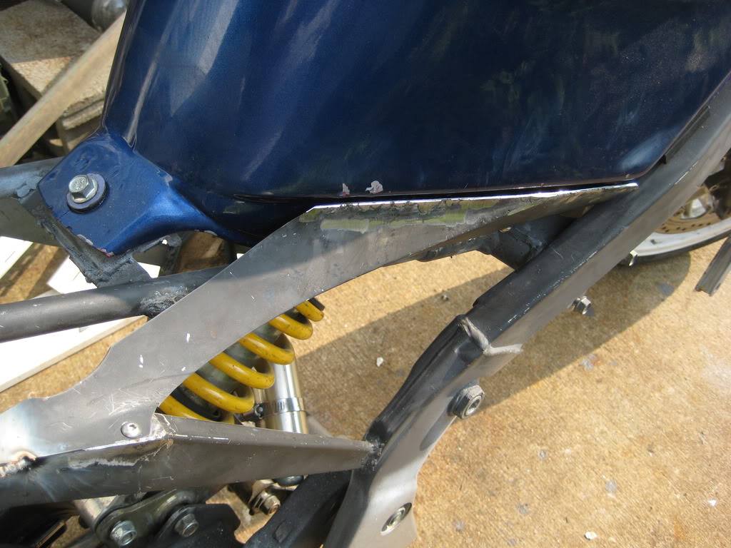

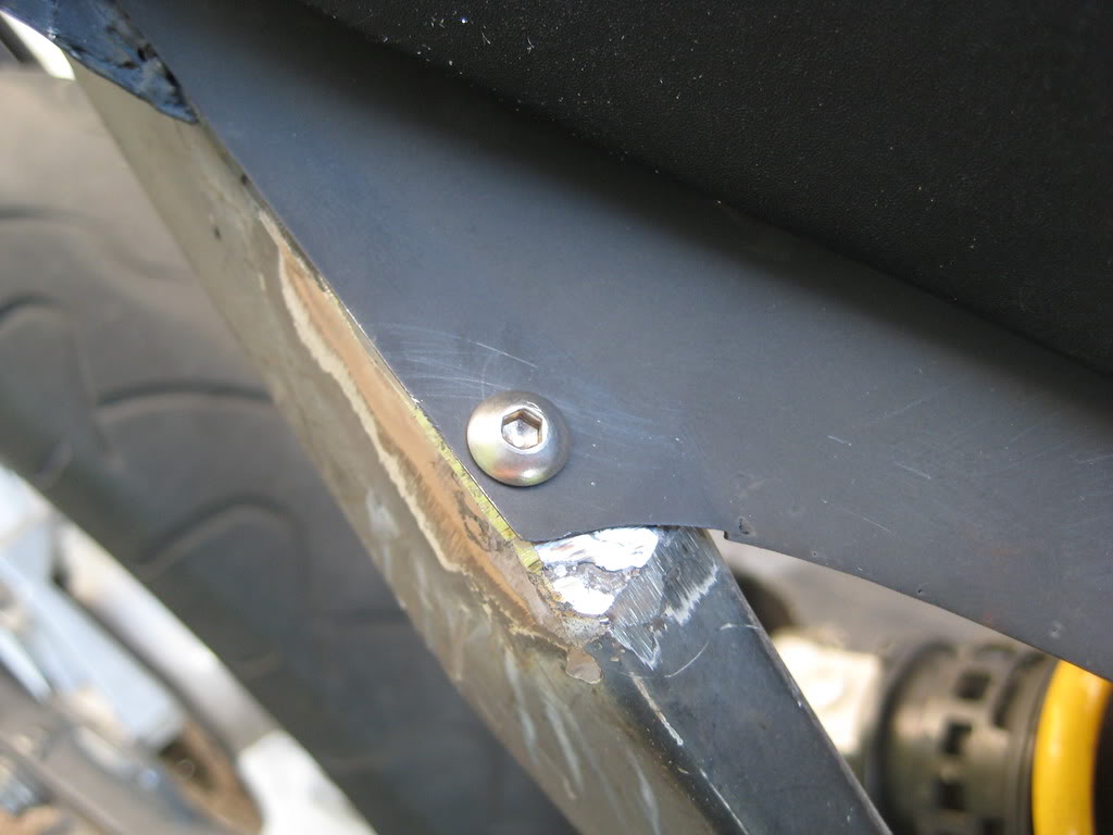

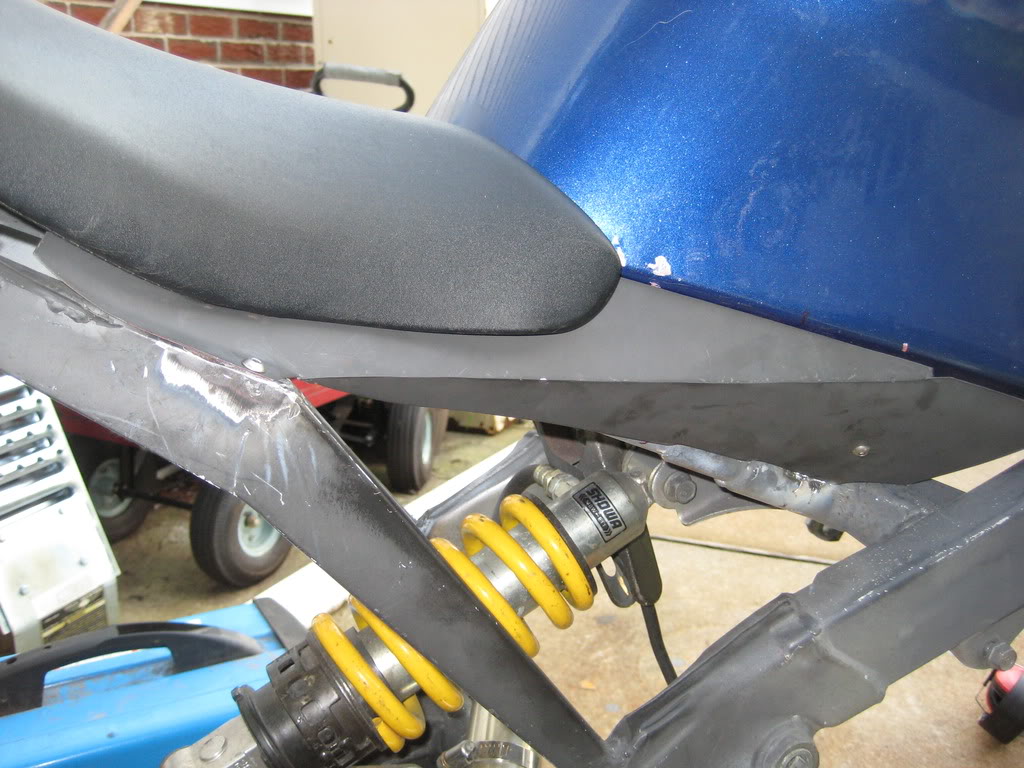

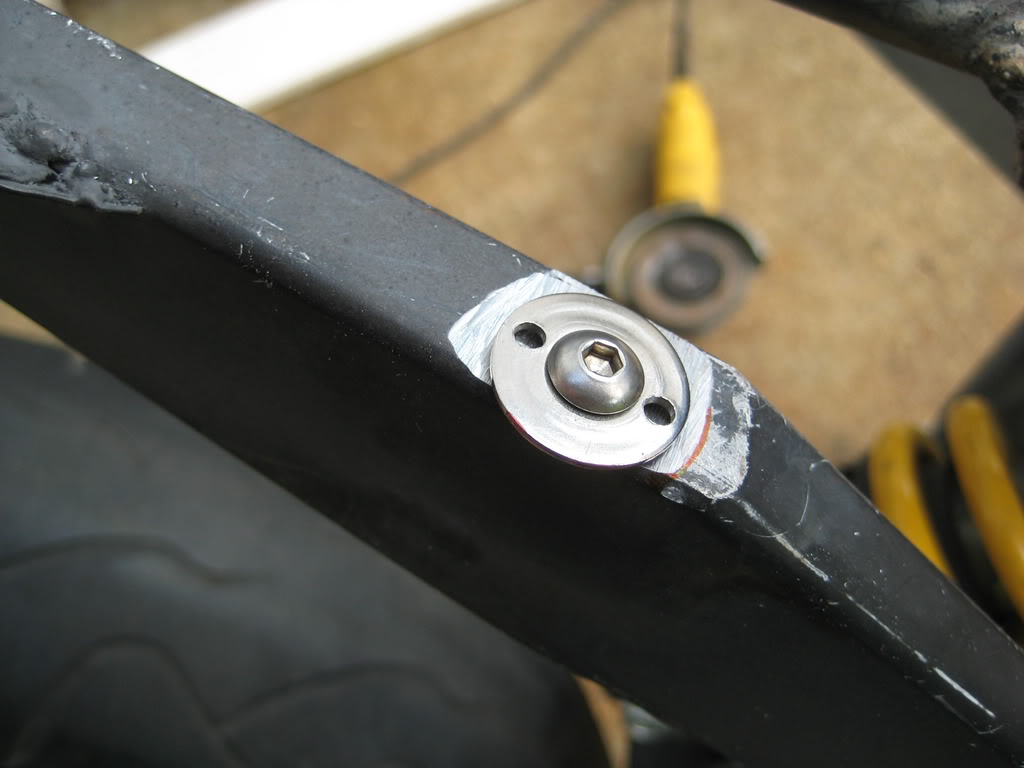

small progress report here...
i figured out how to mount the side panels and probably the tail as well.
I picked up some of these from the hardware store. stainless steel bolts!
so i drilled a hole though both the panel and the frame, widened the hole for the insert, and ground a recess so after welding it would be flush:
and after it was welded and ground (kept a sacrificial screw in it to keep crap out of the threads)
the other mounting point was easier, as it was just a tab welded to the frame with once of those nuts welded on the back. and here you have the mounted panel.
it still needs to be fine tuned before it gets copied in CF, but we are getting closer

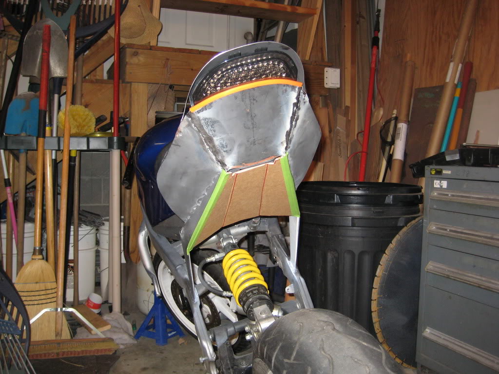

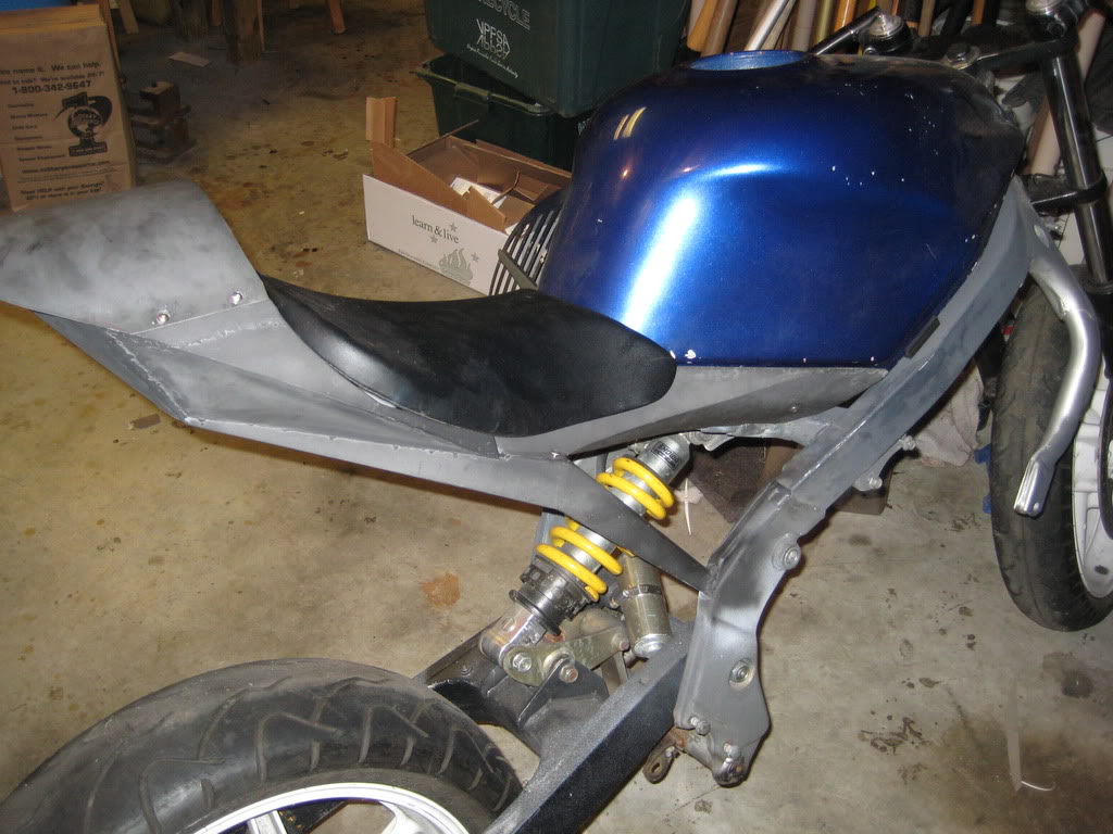

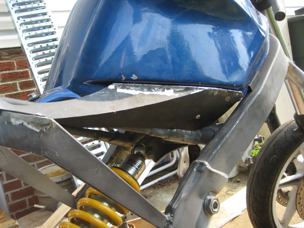

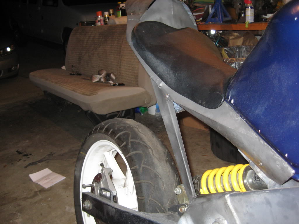

the last week has been really busy for me, and the work that i have gotten done ha been relatively unnoticeable. I have tweaked alot of the stuff i had already done, primarily the side panels and the tail, but also the undertail and i filled that "hole" in the side of the tail.
I only have a little bit more welding before i can do the finer grinding and bondo work.
fitting alot closer...
the metal is there.. and the bondo will help with some of the "blending"

I am considering making the tail carbon fiber as well... and just using the steel as a mold then cutting it off except for "tabs"
what do you think?
