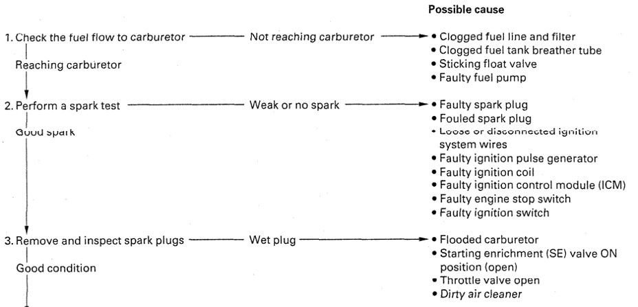

Follow these steps from the manual

Unforunately I would start from the basics.
Sort the kill switch or you will never know if it is cutting the ignition. Sounds like the ignition circuit is working but you need to get it sorted.
Sort the throttle / carbs out, if the throttle is sticking open it will immediately flood and kill the engine.
As it has been sat for a while I would recommend stripping and cleaning the carbs, you may have to do this anyway due to the sticking throttle.
The idle circuit on these bikes are notorious for getting gummed up and causing starting issues.
