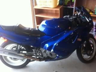

Before I could wash it..paint job is actually pretty decent..the kid I bought it from dropped it on both sides post paint job and so it's a little beat up but not bad. I plan on repairing the plastics and vinyl wrapping the bike...maybe a repsol spin

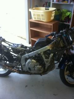

plastics / tank all removed

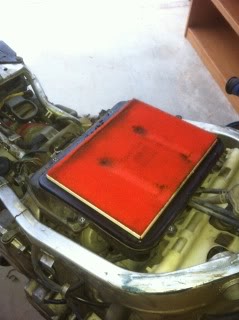

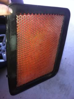

wanted to inspect the bike..so far it's got a newer air filter and a fresh oil filter and oil change thanks to the prior owner.

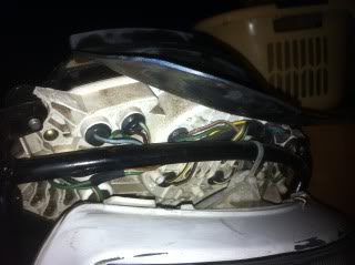

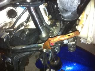

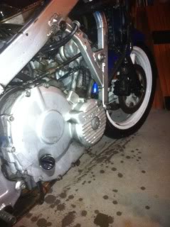

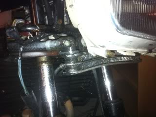

So I found this when I pulled the front fairing off.. A prev. owner had a neon in the rear fender..removed that and the make shift rusty bracket ( thank god i've had a tetnis shot LOL)

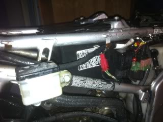

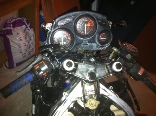

Ok so my ? now..When i hit the front brake the brake light doesn't come on but works normal with the rear brake. What/where do I need to check in order to fix this?

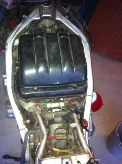

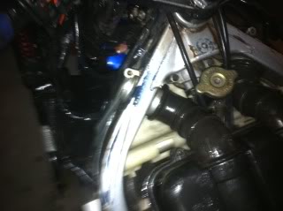

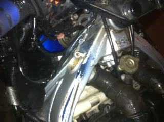

Also in the pic of the airbox do the intake tubes need to be hooked to anything on the frame..they don't exactly line up perfect with the intake holes in the frame. I would think there's alot of turbulance in this area....??

My front brake was doing the same thing. There should be a little unit on the brake lever bracket that has a button for the brake light it has several screws (as I remember) but easy to take off, I just cleaned it and made sure it was working properly off the bike. When it's engaged the brake light should be off and when the button is released the brake light should come on.
As for the intake tubes mine line up for the most part but aren't really connected, just sort of sitting there with the holes in the tubes.
Very Very nice looking cane! And, no the intake tubes do not directly line up, not a major issue as our bikes are not so much a forced induction design. I know of some setting their tubes up so that they run forced induction (varrying by the speed of the bike) and it ran like crap. Just a little UFI for you lol. I can tell you are very excited about having your cane just by your posts. And I will definetly say, my cane has been amazing besides a few mechanical issues that took a while to rectify with the carbs. (Went through 3 sets before I got it running properly) Long story I can tell later if youre interested.

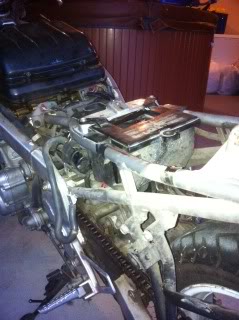

I didnt notice from your pics, but im sure you would have seen it. Alot of owners have noticed a stress crack in the frame on the right side above the engine, so if you havent noticed or checked maybe just take a peek to ensure yours doesnt have it, or if it does, just get someone to throw a bead of weld on it for you.

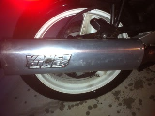

Thanks alot guys! So far it's been fun wreching and riding it. I took the slip on exhaust and polished the crap out of..came out looking really nice!
Juan i'll check out that switch ..prob needs to be cleaned like the rest of the little things on this bike.
