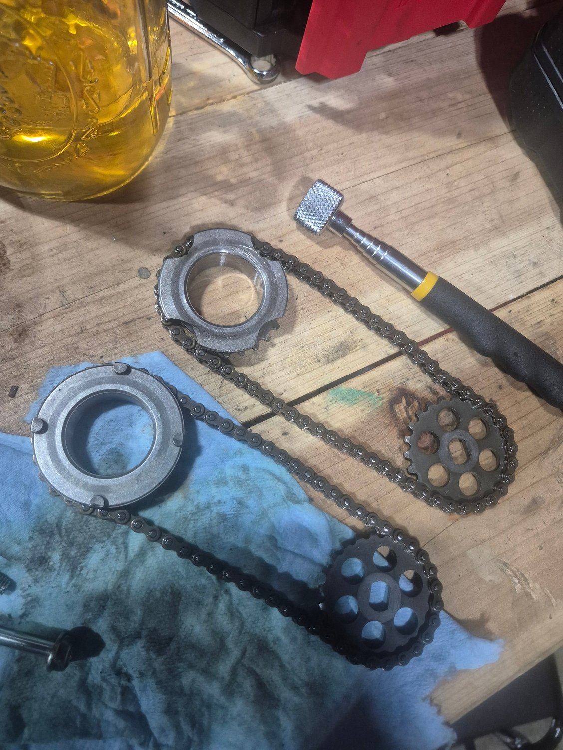

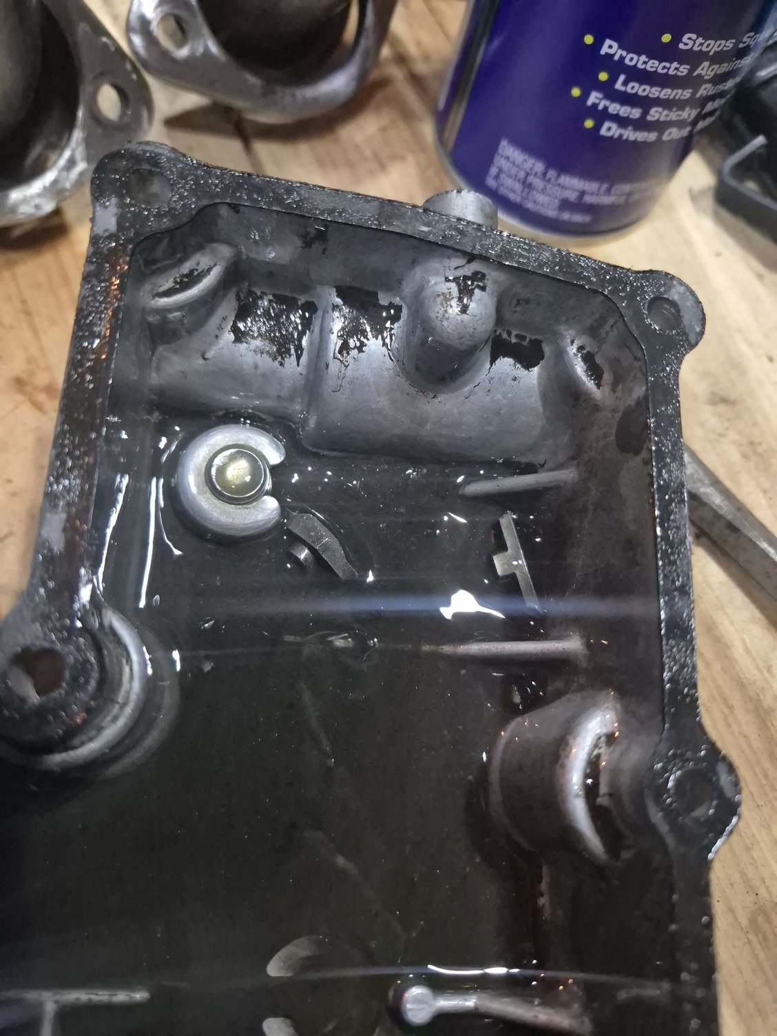

I think I have found my issue, I dropped the pan and noticed chunks of metal and I thought the oil pump exploded so I went to remove the clutch to gain access to it and it was quite stuck and after some work it came loose and revealed the drive shift sproket that sits behind the clutch completely destroyed its self, I have no idea how this happened but is this normal?

is it normal for the drive socket to be destroyed? Is this really your question?

I guess my question would be is this a normal fault point?

Lol that makes more sense - I've been reading this forum for a few years now and I can't recall anyone else having your problem - CBR600 engines are renowned for being mostly bulletproof.
