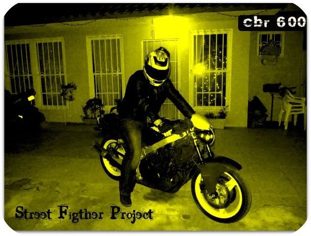

with the silicone works great, thanks to everybody!!! runs greats!!!
almost done my Project
