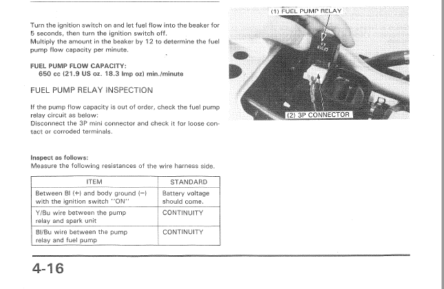

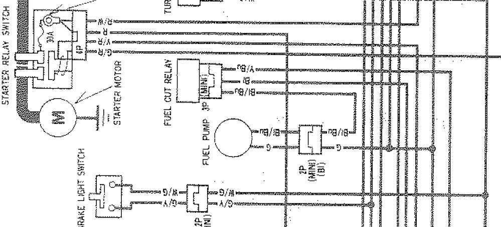

I also have a fuel relay, but for the life of me I couldn't find where to plug it in?

As regards Relay and position
Attached Thumbnails To gravity feed or not?-fuel-pump.png   To gravity feed or not?-relay.png

CaBaRet, thanks for the diagram.
