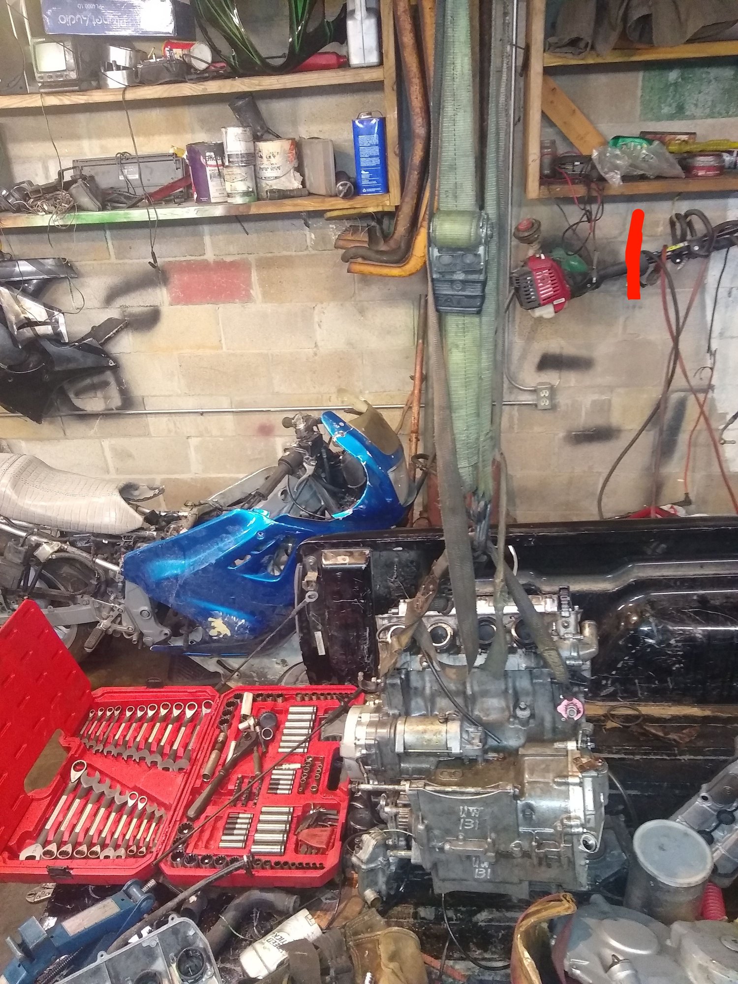

Default CBR600F2 motor in a 89 F1
Originally Posted by rrasco
keep looking, i found a running engine for the f1 on ebay for $400. it was that or rebuild it at the same cost, i opted for a replacement. i think the f2 will bolt in, but im not sure. i looked at some f3s and was pretty sure it would fit, so one would assume the f2 would too.
The 89 is same as my 87 here. i bought the Blue 87 CBR600F1 really cheap from a guy that bought an F2 motor for 200$ and seen it wouldn't fit.
but now that i look at it. although the motor mounts are slightly different with a little engineering work it can fit. but the motors are made different internally so crankshaft and cams and transmission are not the same. but i believe pistons and rods are interchangeable.
i only gave a 200cc custom chopper for the F1 Bike with title, it's original motor and the F2 motor. i maybe had 100$ and 5 hours time invested in the mini bike. score 🤟😁
