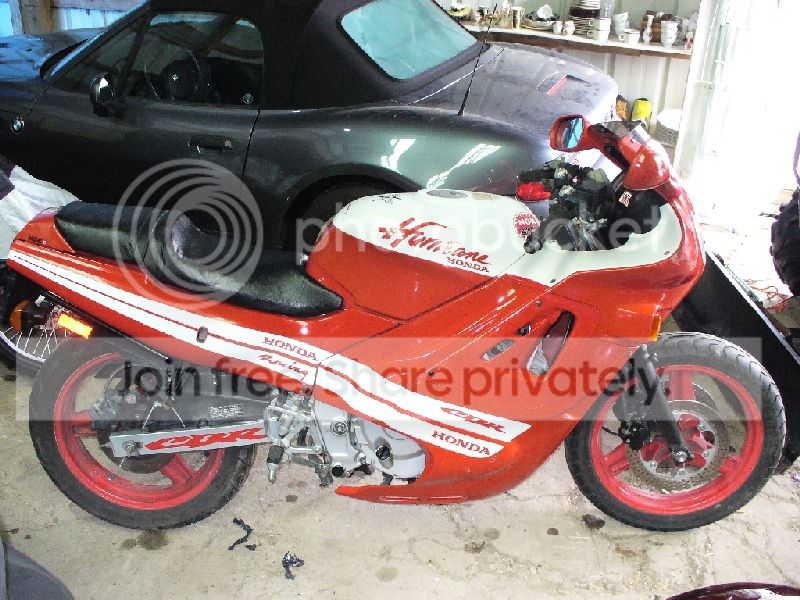

No, I got the complete bike with the fairings and another complete bike in parts both with titles for $400. Here's the complete bike:
I know the numbers that the bikes go for running and it really seems too bad (well not for the buyers), but then nice ones are probably worth a little more. It's why I likely will never sell the conversion bike.
I have so many CBR parts that I could build 4 bikes and still have parts left over. Likely will buy more along the way if they turn up and the deal is right. The other runner I have had a front and tail fairing. Over the past couple of years I have bought a ton of fairings...I have a three perfect complete front fairings and two really nice full sets. Plus a few other side fairings that need a little work to be nice.
