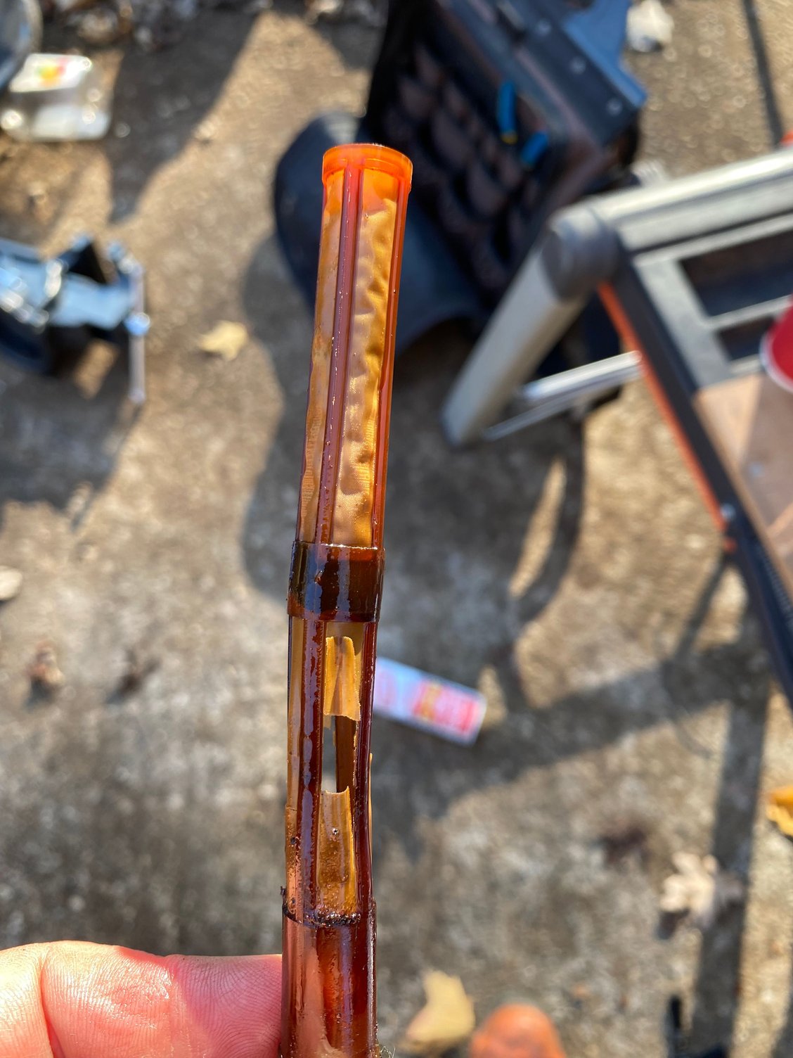

Do you guys think I need a new tank fuel filter ?
seems like a shame to have to buy a new petcock just to get a fuel filter, but @Al1040 indicated I might have to do that.
also took a look at the inline fuel filter today. I poured some water in the inlet and held the filter vertical and absolutely nothing passed through. I was able to blow gently through it and now I get a trickle. I am going to replace this anyways.I am assuming I can use any filter with the right size inlet and outlet sizes. Are the fuel hoses 5/16” ID ? I took the filter to our local store (affectionately called “Crappy Tire”) but they didn’t have any hoses that fit (all 1/4” or smaller).

@NuggyBuggyCBR So why can't you just buy a new one? Seems to be available.
https://www.partzilla.com/product/ho...19e8ff0e673d2b

NuggyBuggyCBR's Avatar
Joined: Oct 2021
Posts: 137
Likes: 15
From: Toronto, Canada
I actually hadn't gone looking for one yet. @Al1040 mentioned he couldn't source a filter without replacing the whole shebang, so I assumed I would be in the same pickle. Thanks - I'll call my Honda dealer and see if they can get me what I need.
