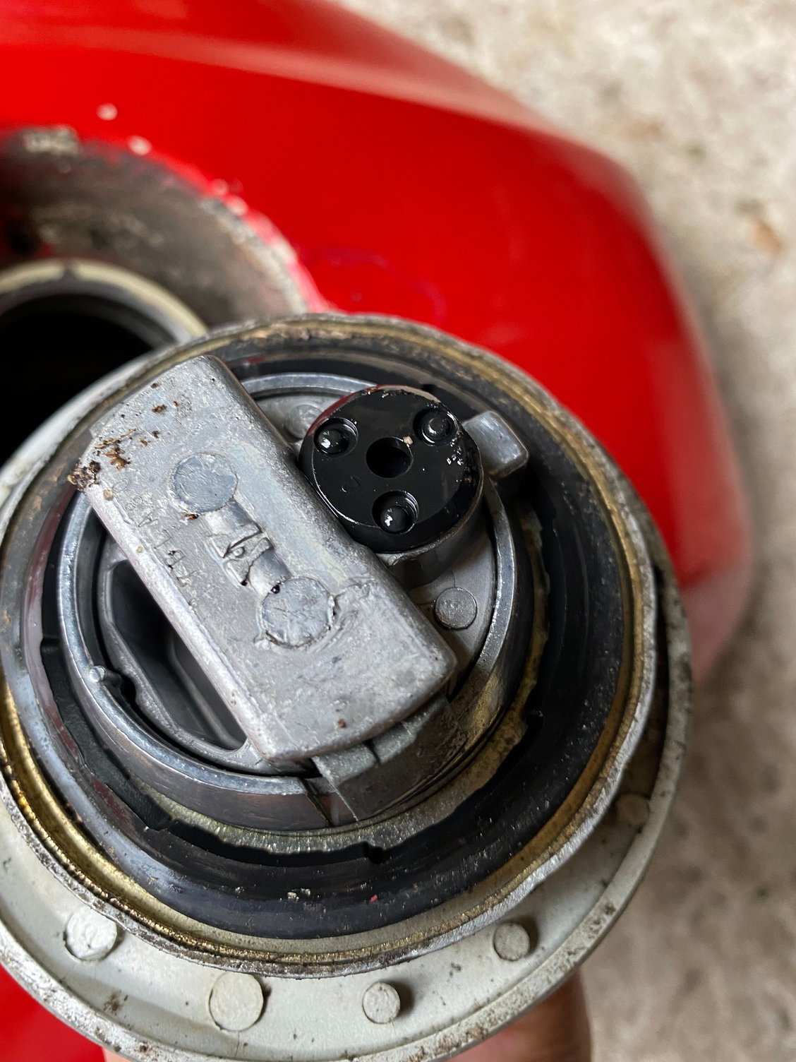

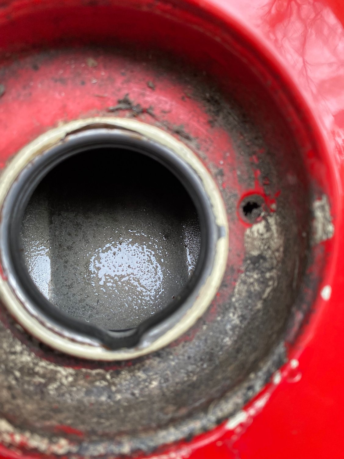

I pulled the fuel tank to see what kind of condition it was in, expecting it to be horribly rusted. I was surprised to find it looked pretty clean, I THINK, compared to pictures of other tanks I have seen elsewhere. . It took *forever* to drain the tank. Even after pulling the petcock off I had to shake the tank around for a LONG time to get it close to empty - is that to be expected ?
i also took a first look at the fuel cap and it seems like there must be something missing or wrong. Turning the key, the entire fuel cap and locking mechanism pops out leaving basically a bare metal hole. Locking is accomplished by pushing the entire assembly in. Could this be normal ? Parts diagram doesnt show enough detail, and the service manual doesn’t really address the fuel cap. The owners manual mentions a hinge, which I do not have, nor can I see how it would fasten.
the exterior of the fuel tank, right under the lip of the cap looks corroded.
I am wondering whether I have some sort of aftermarket cap… The keys say “Junken”.
Thoughts ?

The interior of the tank gives the appearance of being sealed with some type of tank liner/sealer. I could be wrong, it just looks that way. Are you able to see into the tank with enough light to see the location where the Petcock was removed? Can you see any buildup of material around it, like it pooled or something? Yes, not uncommon for gas caps to just come off and leave just the opening. Usually the key won't come out until you put it back on and latch it. It prevents you from riding away from the gas station without the cap.

Caps on the first F (F1?) 87-90 were seperate, unlock and remove, push in to re-lock. F4 (98 on) and later were flip up, attached by pivot pin. Can't rememeber what was on F2 & F3. Sounds like you have a replacement key, original said Honda with wing logo.

I'll bring an inspection camera to the bike this weekend (I keep it at our cottage), and hope I can get it in around where the petcock came through, but I'm not sure how I will do that. I wonder if I could get the camera up through where the petcock installed. Hmm...
Is it normal to have a hell of a time getting the last bits of fuel out of the tank ? I had expected I would be able to position it just so and have it all drain out, instead even with the petcock out I had to shake it constantly to get the last bits - maybe 250-500 ml ? - out. Each shake would get maybe a few drops here and there.
