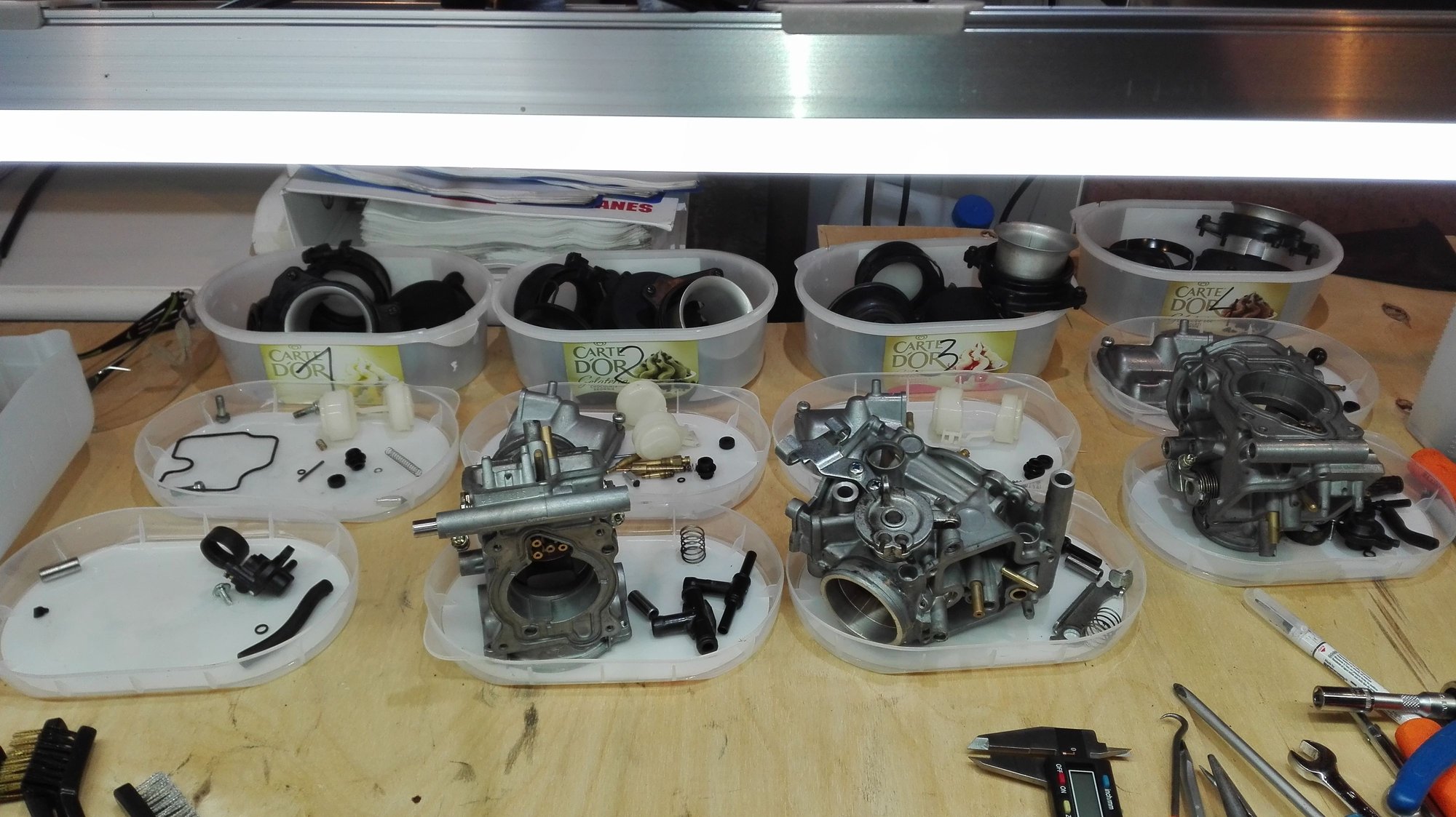

Hello,
Such a problem, it is bad to start up on a cold , with open suction, it is necessary either to turn for a few seconds o, it also starts up on a hot one after the crankshaft rotates three times.
Best regards
Artur

Hi,I last regulated 2017 ~~90000,the moment shows 92316,2018 carburetor cleaning.

Old Apr 5, 2019 | 01:07 PM
art30's Avatar
Joined: Apr 2019
Posts: 8
